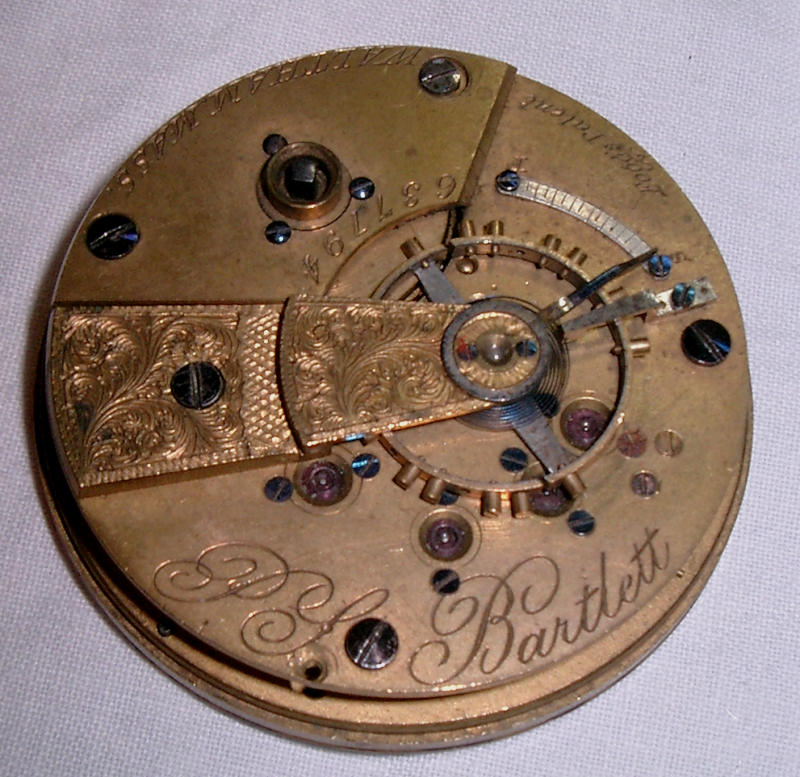

Hi all,
Venturing into this forum with a recent acquisition of a Waltham P.S. Bartlett movement that came in a Waltham shipping container, and wondering if anyone can give me some info about it.
Is it junk, run of the mill, or a reasonable find?
Paid around $40 for it as a job lot inc shipping.
The container is shown in the Waltham database, I doubt the movement and container started life together.
All and any comments appreciated!

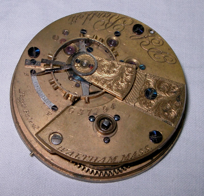

Another movement view.
The movement is crippled at the moment, as the mainspring barrel cap is off, and the bridge is loose - note odd screws too!
Rest looks reasonably ok though.
John

John, I suggest that you confirm common serial numbering for the major parts. If all the numbers match, and as this is an 1872 vintage P.S. Bartlett model 1857 11 jewel watch with "A" grade finishing, it would be a fine piece to restore.
The original Hands would most likely have been blued steel or black. Given that it is a Key Set watch you need a square hole Key Setting Minute Hand, and whatever style minute hand you find then dictates what you use for the hour hand.
If there are any "odd" screws, including the one you mention on the barrel bridge, check their tapped hole with a "normal" screw and confirm they have not been "repaired" to use a different (odd) screw.
As for parts to restore this, our very own Brian Cavanaugh at pwpartsetc@pwatch.com can usually help you if you can give him a description of the parts you need.

John, This should be a pinned dial, remove it (be very careful to recover the dial pins and SAVE them!) to confirm that this is an 11 or 15 jewel watch. Then BEFORE EVEN ATTEMPTING to reduce the watch further, I suggest that you get some isopropyl swabs ready and soak the wheel pivots and friction jewels to soften the "rivets" of fossilized fish brain oil that has hardened into little "heads" that break off balance, train wheel and pallet pivots.
If the balance wheel is stiff, it too may be riveted" to the jewels, and for that you may have to see a watchmaker. Our "1-dip" (a nasty nitro solvent which kills you if you breath too much) does break down fossilized fish brain oil, but an experienced watchman usually has some "trick" up their sleeve to preserve the Balance staff pivots during removal of the balance wheel from the dirty jewels.
Then to take the plates apart, first establish some meaningful end-play in each wheel by reaching in between the plates with your clean well sharpened #5 tweezers, CAREFULLY pull up on the top plate watching the pallet through the balance wheel entrance hole to make sure it is not "teeter tottering" at an angle and breaking its pivot.
After that it's not much more than fixing a clock! Razz

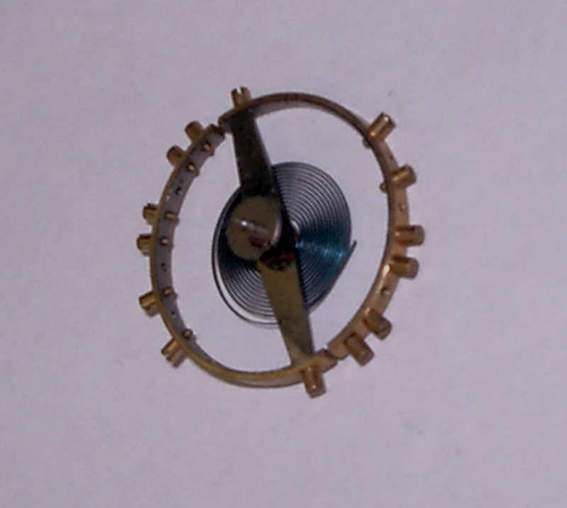

Good balance, pivots and flat blued hairspring - no rust!.
As you said Dave, steel balance, and a cut bi-metalic type at that.
Think all the timing screws are present but need to take another look later.
JW.

John, Very good work so far. I suggest that you concentrate on cleaning things, and avoid taking too many more things apart until you can see through the goo and rubbish they are coated with.
If the seconds wheel staff is exiting through the correct spot, please leave it alone, as it WILL break if you try to straighten it. Also at reassembly be gentle with pressing back on the seconds hand.
Regarding the two cover plates on the top (dial) side, I would remove the cover, spring and "click" for cleaning, because you will be reassembling those anyway AFTER you have installed the newly wound mainspring and barrel at reassembly (or you will go nuts trying to "fish" the spring arbor end into the click gear.) It is so much easier to just put it on after the plates are together on the othwer side.
I would leave the other (pivot) plate that is held on by two screws alone, just clean it and the pivots. Removal and reassembly could mess up the wheel alignment.
For the "rustbound" Hour Wheel/Cannon Pinion, try to find the concrete CLEANER (GREEN STUFF) used before coating concrete driveways. It is formulated to remove metallic oxides only, and works very well on rusty ferrous stuff and "green" copper based stuff. As a passive rust remover soaking parts in it will help de-rust and disengage things like the Hour wheel from the cannon pinion. (It also de-rusts watch hands and pallet forks)
When you decide to remove and clean the balance jewels, press them out with a piece of pegwood so they are not cracked by the force. If they argue too much use more isopropyl for a few hours and try again.
The pic shows the green cleaner and also the dial cleaner I use, whith some hands beiung rerusted and a dial being de-"hair-lined". The green stuff is excellent for this because it only removes the rust, then you just re-polish things and you are "back in business".
FINALLY Roll Eyes please do not touch the banking pins, as they are adjusted already, and re-adjusting them may never be quite right again. Only touch them AFTER all else fails.
