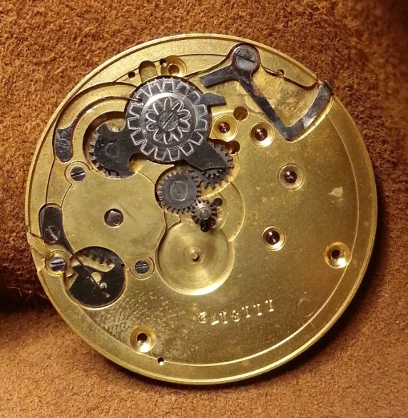

This one is serial number 1113172 and crosses to an RR Grade 15J course train 15J HG2L TPI RRG (adjusted - patent safety pinion - gilt)

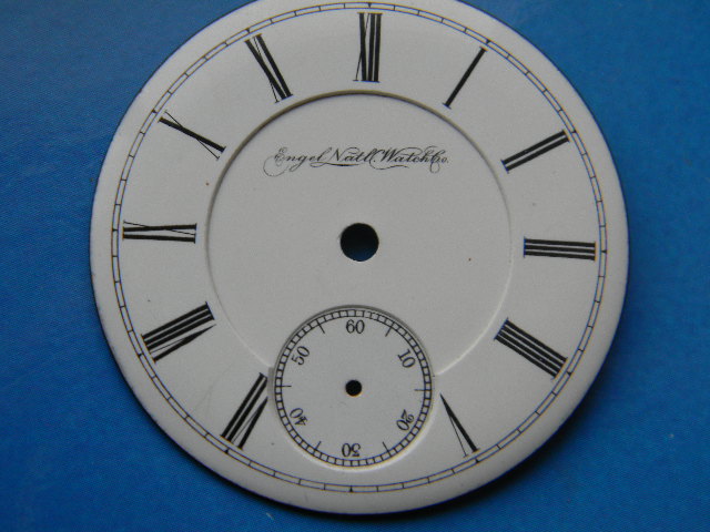

So, I waited out a dial and ended up with another nice movement. In fact, this movement is in mint condition compared to the other.
Now I don't have the heart to part her out and instead, have her in line for a second Engel build. Problem is, it is an expensive proposition. Decent hunter case $200, decent dial $100...

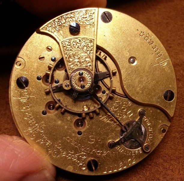

My question to you is how to read the jewel count on this style watch. The book says 15J, but it looks like 17J to me.
This one is a model 2... the other is a model 5... They sure look like twins to me... not much difference between the two movements.

Front plate

The center wheel is jeweled... Therefore, would think it is safe to say you have a 17j 18sz IL. Plus, I do not recall ever seeing a 15j or less jeweled model 18sz IL that is stamped "adjusted" on the movement plate
February 03, 2014, 14:03
The Engel you picture here and the other discussed in "Illinois RR King #2" are nearly the same the same but with one big difference! This is a VERY UNIQUE 17J model 5 and the other (you moved the dial over to) a model 6. I would consider restoring this one with the dial because it is even more uniquely rare model 5 with 17J with a truly original Dial and Balance wheel.

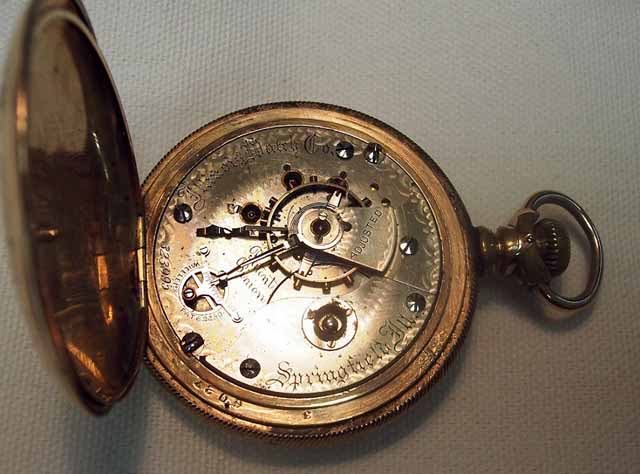

Interesting topic - found a 15j that is marked adjusted on the balance arm

I have this dial in my dial drawer do you need it.
February 03, 2014, 21:55
Paul D. Trombley
Absolutely, please email me with particulars.

That 15J Adj is quite interesting. All these pre-date the official RR specifications...

I'm curious as to how you count the 17 Jewels here.
Thanks.
June 03, 2015, 10:44
Paul D. Trombley
Larry,
The records show it being from a 15J run, but I've had it apart and it has 5 paired jewels through the center wheel making it a 17J watch.
It's hard to see in these dinky photos... but if you Ctrl roll to blow up the photo, you can see the center wheel jewel under the edge of the hair spring and the other under the cannon pinion.

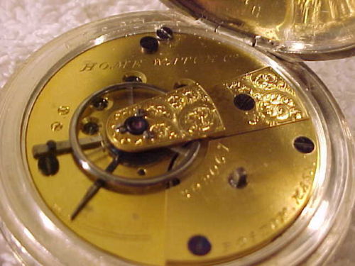

If you blow up the example Jon added below mine, you can see that the center wheel is not jeweled.
The assumption is that it was upjeweled before it left the factory.

As a rule, jeweled to the 3rd wheel is 15J and jeweled to the center wheel is 17J. It gets a little squirly when we are talking about really early movements that are only jeweled on the top where they are visible and not jeweled in the pillar plate.
For example, I just landed this underspung circa 1869 model 1857 SN: 392067 that looks like it should be 15 jewels, but is actually an 11 jewel watch.
With typical escapements, we assume 7 jewels for the balance and pallet, then count up from there.
