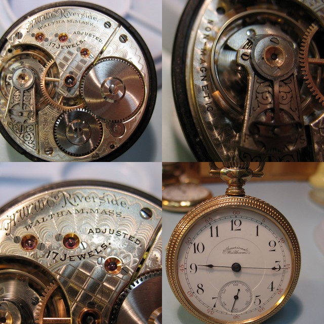

There is no doubt (in my mind) that many Waltham 1888 models were RR capable. I recently posted this Pendant setting 1894 vintage non-magnetic 17 Jewel Waltham model 1888 which would easily pass RR standards until at least 1908 when the lever set rule was put in place.
This beauty is a signed "non-magnetic" movment that was made with a non-magnetic balance spring (what looks like) Beryllium Copper or hard brass pallet fork, Hanging Motor Barrel, 5 Position adjustments, a steel escape wheel and the patent micro-regulator.
When I cleaned this it was so fine and spotless that I re-poised the balance wheel and added the fine adjustments to assure it is within 30 sec/week.

and the whole watch presents very well for a 114 year "old-timer".

David,
That is a beautiful 88. I know they are fine movements, but I wondered why they were not made for RR service.
It appears the vast majority were made in 15j or lower. Why did Waltham regulate such a fine movement to it's lower priced watches?

The design of the 1888 model which was an upgraded model 72 movement was one of the more actually expensive watches in Waltham's line.
The DOUBLE ROLLER 17 Jewel Riverside I picture above was selling for $30.00 whole uncased when the Model 1883 P.S. Bartlett 17 Jewel RR adjusted was selling for $22.88.
Later, the much costlier, but not particularly better SINGLE ROLLER Model 1892 "845" purpose built "high end" 18s RR model was $36.00.
