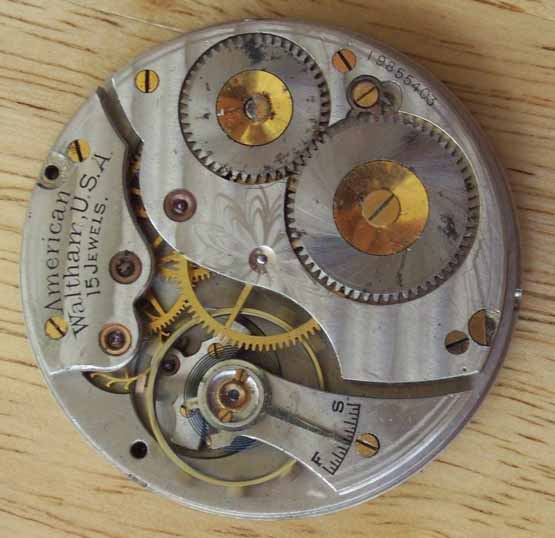

Hi, I'm a new member and new to this passime. I've always loved watches and recently bought a few old pocket watches to 'play with'. I've stripped and cleaned a few with varying success, but I'm learning and I'm hooked.
I just bought this:
http://pages.ebay.com/link/?na...view&id=300935174693It was supposed to be a Size 16, but the Walthum site says its a 17s  Equity.
it still runs well but I would like to put it in a case.
What are my options as hunter cases seem rare and 17 s even harder to find.
Can I fit it into any other type case? I'm not looking for the world, just a case that I can use to wind, set, and display it now that I've cleaned it got it working after my efforts.
Does anybody have one or know where I can get one?

Welcome to the forum.  Interesting watch you have there.  From what I can find this is a 17s, not a 16.  I'm not sure what case might fit this one.
But it is one of fairly low production numbers.
Will be interested to hear from others here who are far more enlightened.
Grade: No. 611
Movement Serial Number:19855403
Estimated Production Year: 1914
Run Quantity: 7000   Total production  17,700
Jewels: 15j
Movement Configuration: Hunting
Movement Finish: Unknown
Model: ?
Movement Setting: Pendant
Plate: Unknown Plate
Adjusted: No
Railroad Grade: No
 Dave Turner

Paul M. WilliamsThanks, i,'ll keep an eye on that, but its incomplete. Its a shame because the movement runs sweet and the dial is good. Its from a hunter case, can I fit it into an open case, will the crown and stem fit? It winds at 3

Richard M. JonesPaul as a general rule a hunter movement will fit in an open face case. They show up all the time and are usually called sidewinders. I say as a general rule because the thickness of the movement must be allowed for and in some cases, as any Hampden collector will tell you, you have to cut a new slot or widen an existing one. I occasionally seen an open face movement placed for some reason in a hunter case but that is usually just because someone had a hunter case and used it instead of an open face case. Remember also that a pendant set watch may not work in a lever cut case as some of the lever cut cases do not allow for pendant setting.

Andy SchwartzI have sold many Equity movements, they were made by waltham. The two gold tone areas of the wheels are typical of an Eqquity movement. Perhaps this is a bit of a frankenwatch made by waltham?

Paul M. WilliamsThanks both, I just need to find a complete 17 case. I'm reading that these could actually be 16 1/2s. I must try it in an waltham 1888 case to check the size. I believe they were slightly bigger than a normal 16. I have to dig out my vernier to measure the exact diameter.
I don't mind the sidewind bit! I just want to case it as its one of my early successes.

Andy Schwartzthe serial numbers on my equity watches are different by the way, that serial number is pure waltham, the only thing I see equity wise is the gold in the wheels.
August 03, 2013, 03:54
Paul M. WilliamsOk, so I just manged to find a 17s equity open face complete, that needs work. It sounds like a mainspring.
Can I put the hunter  movement in the new case or should swap springs?
Will the stem and crow work on the hc or will it need to be modified?

Mike HodgeI would think condition of the movements and your desire for "correctness" will dictate.  The easiest thing to do would be to stick the running HC into the Non-running OF case.  If you are comfortable changing the mainspring then that may be an option, or, simply find the correct mainspring (looks like the 2227 is correct) and repair the OF as well.

Paul M. WilliamsThanks Mike. I had narrowed it don to the 2227. Even tho it is listed for a 16s. There a a few that are prewound (bestfit) so I'll probably give it a go. Do I need any stem or crown modification to fit the hc in the of?

Mike HodgeGenerally a Hunter movement goes into an Open Face case and Open into Hunter without any modification.  Of course, that depends on the cases involved, but if yours housed a similar movement it should work fine.  There may be a sleeve adjustment required but not often.  Good luck and keep us informed.
