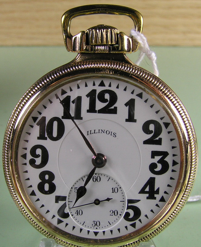

No. The Mainliner was wade only for the Hamilton 950E. A similar case is shown below that was a case that was sold by the jewelers and I have several of them. A very handsome case and quite popular. Here is a picture of one of mine that has a Bunn 19 jewel 60 HOUR movement in it with a "Fatboy" dial.

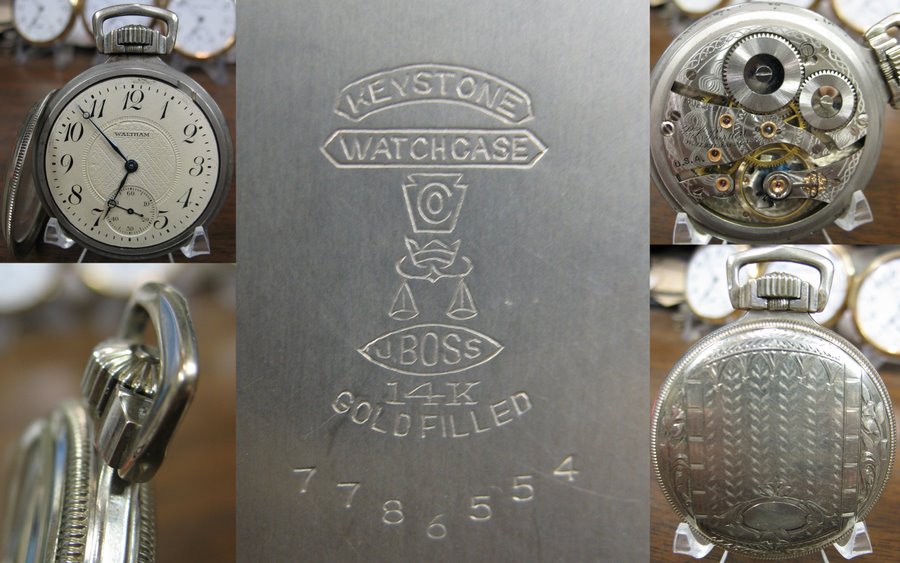

Expanding slightly on Steve's comments above, the case known as the "Hamilton Mainliner" is a correct case for one movement and one movement only, the Hamilton 950 Elinvar produced from 1937 through 1940 inclusive. There are several very important design features exclusive to these cases, follow the link in Steve's second post above and for more in-depth information about the true Hamilton Mainliner and additional difference details then follow both the links to be found below in this posting.
Long before the Mainliner, in 1924 the Keystone Watch Case Company began producing their "J. Boss Railroader" case that is similar in basic design but in actuality a very different case. Keystone sold it to the retail trade and vast numbers of watch movements such as Steve's were cased in them by many retail selling jewelers. There were also factory cased watches from Waltham shipped in those cases (watch guide page 136, reference 4) but those will bear clear Waltham markings inside the back.
The Keystone "J. Boss Railroader" was produced from 1924 until the 1970s and thousands of movements were originally cased in them, thousands more were placed in them as replacement cases. It is arguably the all-time most popular Railroad Watch Case, but it is very important to not confuse it with any other similar looking case.

Thank You Lindell and Steve, and this brings to mind a question . . . This mint looking case arrived here wrapped around a mid-20's 17J adj PSB with a busted mainspring from an eBay seller that had listed it along with a toothpick holder, antique Stanley wood plane, old dishes, etc.,etc., so the picture was so bad that nobody bid it so it came here. It cleaned up to a mint watch!
Would this case be "appropriate" for a higher end RR such as a 23 Jewel 60 Hour Sangamo Special?

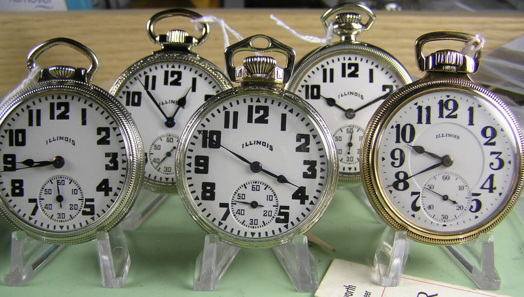

Pictured below are 5 Illinois watches that are not in factory cases. What is unique about four of them, and this was the way I received them and it led into another discussion I had with Lindell a few months ago.
Four of them have Hamilton style dials on them with the two in the back even have Hamilton style hands. I belive those four were put together at the hamilton factory.
The one in front on the left is a Grade 706 19 jewel Serial # 5300858 (1930).
The two in the rear are both 19 jewel Bunn 60 HOUR watches in non factory cases.
The center front is also a 19 jewel Bunn 60 HOUR in a Ball case.
The one on the far right is another 19 jewel Bunn 60 HOUR in a Keystone Rail Roader case.
Is it coincidence that there are four Hamilton style dials on Illinois watches? I think not. I believe the 60 HOUR models, all of mid 20's manufacture were left over units after Hamilton took over the Illinois factory. These were all of the less popular, slow selling 19 jewel variety, That were left sitting in the vault. There were less than 4,000 of these produced and here are three with Hamilton style dials on them.
The Grade 706 model I think reinforces the fact that they started using these dials in the 30's to get rid of surplus and were sold to jewelers as uncased movements to get rid of them.
