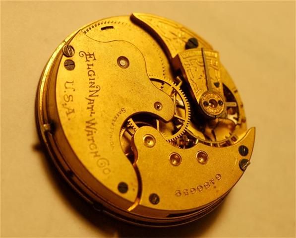

I have what I believe to be an Elgin National Watch co. Model 3 gr.114 16 sz movement.Serial #6486659 The winding stem exits the body as a stud instead of the more normal square socket. The old movement runs well but I'd like to find some kind of case ,hunter or open ,or a winding stem to convert another case... Or some advise as to how to case this movement, Thanks Mike

I've run into this problem too. You need to look for a 16s case with a setscrew in the pendant--these have a female stem square that accepts the male winding stem of your Elgin Model 3 movement. These cases are hard to find but do come up for auction on eBay and I've bought several this year. It sometimes takes patience to find one.
All 16s Elgin model 3 watches are housed in cases with setscrews like this and have female stems.
Other Elgins movements with the setscrew pendant case and the male winding stem are the Model 1 and 2 types, and both these are convertibles, and cases are even harder to find for convertibles. The Elgin Model 4 (doctors watch) also has the male stem movement, but a case for this model is extremely rare, and probably wouldn't work because it is deeper (thicker) to accommodate the sweep second wheel. I don't collect other brands of watches, and don't know about their cases and stems. Maybe someone else can help out with this information.

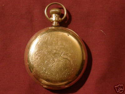

Sheila here is a case that recently sold on IHC 185 with the female stem on the case.
stem
June 02, 2009, 19:01
Here is the side view of the case.
case

June 02, 2009, 22:12
Sheila
They all have a stem one way or another, most have the female part in the watch & the male half is in the case, but some are the opposite, like the one in this post. If you have any movements laying around without cases, look at where you wind it, most of them will be the round cylinder with the square hole in it, that is the female half, it will look quite a bit like the end in the case I posted.
I will get some photos taken & posted later this evening, unless someone beats me to it.

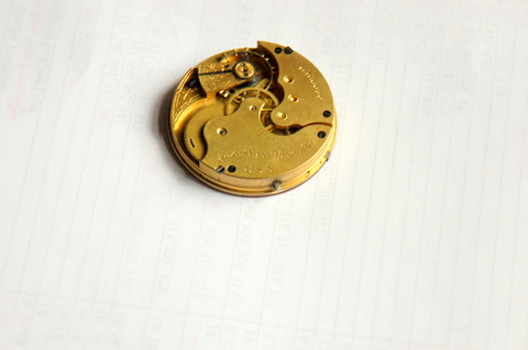

June 03, 2009, 16:05
Michael Riska
another try
June 03, 2009, 16:06
Michael Riska
Well Finally !! Mike
