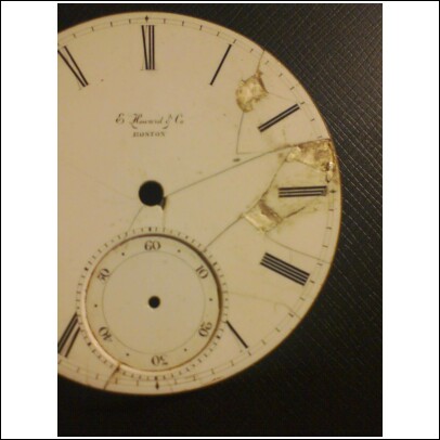

Several months ago, I bought an E. Howard series III, serial #12444. The dial was in bad condition with several big chips and old repairs.

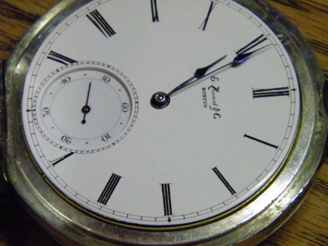

Mary Ann ScottAfter researching I decided to get it repaired and sent it to Allan Heywood in Australia. He did a resin repair/resurface. The dial turned out great. You can only see signs of repair when you turn it to the light just so and there are the outlines of the old chips.
Did I mess up by having the dial repaired? Did the dial lose it's value being repaired?

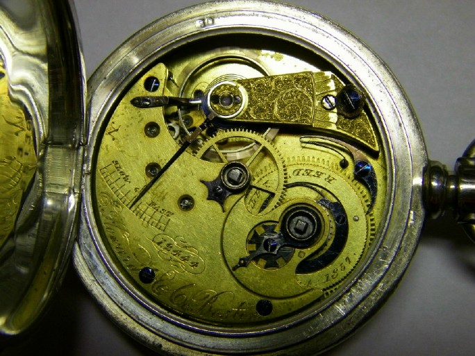

Mary Ann ScottHere is the movement....

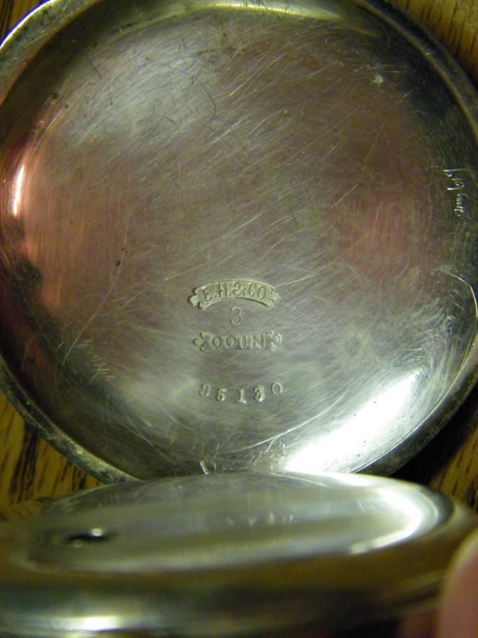

Mary Ann ScottThe case is marked E.H.& Co., 3, coin, 85130. I believe it to be, if not original, at least a period case. There are no extra screw marks, however, there is a "washer" under the case screw.

David AbbeMary Ann, Regarding your question;
"Did I mess up by having the dial repaired? Did the dial lose it's value being repaired?"
If the damaged dial is an original and has been restored, I see llittle difference between doing that now or the previous attempt by a watchmaker to repair this with white dial wax.
In either case it remains the
ORIGINAL dial that has been restored, albeit a better job the most recent time that was done.

Larry BuchanWonderful dial restoration Mary Ann, I too would be interested in finding out the cost of this type of repair.
March 07, 2009, 13:10
Mike SandellHe did a real nice job on that dial.On one of my Howards the dial had some hair lines and chips.At a mart I know a another Howard collector he sold me a dial for 10.00 it had a minor chip but was better than what was on it.If you think it look's better that is all that count's.And your dial look better than my 10.00 dial.I can't see any hair lines or chip's it's a 100% improvement.

Harold VisserMary Ann, I can't tell for sure but it appears to me that your watch is lacking the dust band around the movement. With the dust band, the movement will fit a bit snugger in the case and you might not need the washer under the case screw any more. The band is not easy to come by,purchase of a broken junk movement is probably the best way to acquire one and maybe get the correct (longer) second hand also at the same time....
The dial repair looks great, that dial style is known as a type 4 dial, typically used on Serial #3501 to around #7500 and is technically not correct for your watch but it is no big deal. It is actually a rarer dial...

Mary Ann ScottThank you, everyone, for your comments. It seems I did okay having it repaired. I paid about $275.00 total including postage both ways. It wasn't cheap, so you will have to decide if you want to spend that kind of money. But he does excellent work and is a very nice gentleman. It took about 2 1/2 months.

Harold - there is no dust ring. I will be on the lookout for a junk movement to see about getting one and the proper hour hand.

The dial repair is simply terrific and if you ask 10 different people there opinion you will get 10 different opinions while all along it is your opinion that really matters....
I'm not one to change something on a watch as I'm sure you or none of us are for that matter, but there are times when it does become necessary and we do the best we can to maintain the integrity of the watch in question....however, the amount of inquires by those that have responded indicates that this is an area of great concern, that is of repairing dials we have on existing watches....
In all, I think you have done quite the correct thing by having the dial repaired and it will make for a great addition to yours or any of our collections....
Super Job....
and you should continue on your way with a great deal of pride....

Edward L. Parsons, Jr.Outstanding repair job Mary Ann, which enhances the value of your watch IMHO.
March 09, 2009, 22:07
Sheila GilbertMary Ann,
That dial looks Fantastic! I just love to see something like this dial being cared for.
It's beautiful!

Mary Ann ScottI have been looking for a parts movement to get a dust band for my Howard as Harold suggested. No luck so far.
I have a question about the "N" movements. Did the diameter stay constant through production? Excluding the Keystone Howards, would a dust ring from a later "N" fit on my earlier movement?
I have been focusing my search on the key wind movements but, if the diameter is the same, could also look at the later stem wind movements. I might have a better chance of finding a dust ring that way. Thanks to all.
