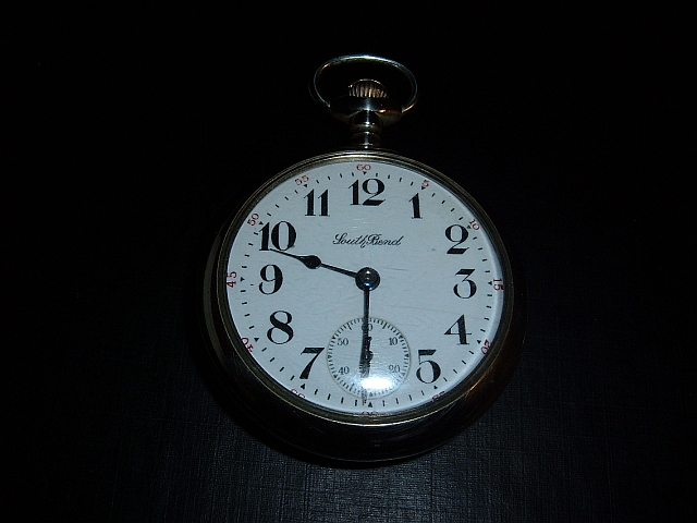

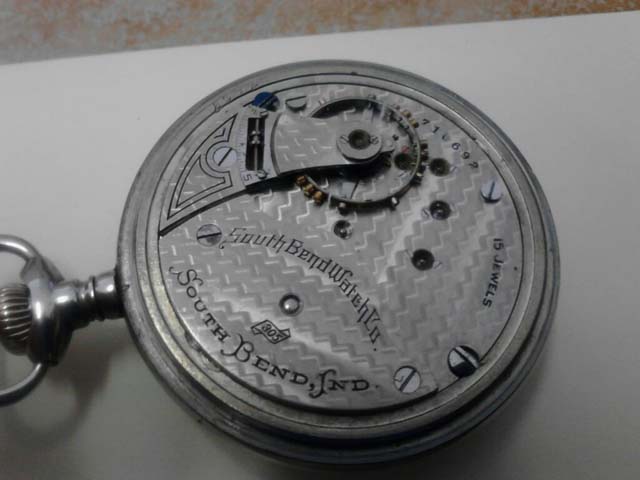

Just bought this watch listed as running well!
But, now I see the regulator is missing? How could it run well?
Anyone have a regulator?

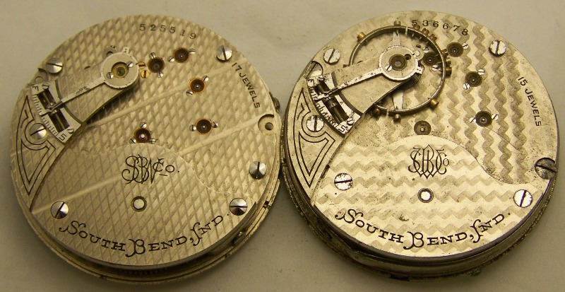

Its a south bend. They can be missing parts and still be running well, just that good of quality Big Grin. I've got one. just drop me an email. Looking quickly for the part you did make me realize that there are 2 different cock arm styles on South Bend model 2 watches. first one is like yours and the other has the hairspring stud attachment location 90 degrees to the left... never noticed it before. I would say they made a change at some point during production as yours is a little later one, but I found a 305 from low 500,000 sn with it in the same location as yours. Guess I'm going to have to check that out further...

The one on the left in your post is a hunter movement?

According to the database the one on the right is a 333, if that makes any difference?

Yes, the one on the left is a 346. And looking thru my watches here, that seems to be the difference on where the hairsring studd attaches to also. makes more sense now. hunting models have it to the left, open face have it on the end.

Received the SB today. It's as clean as a whistle and keeps near perfect time so far, without the regulator. (For the last 5 hours anyway).
Nothing spectacular but it's my first South Bend.
