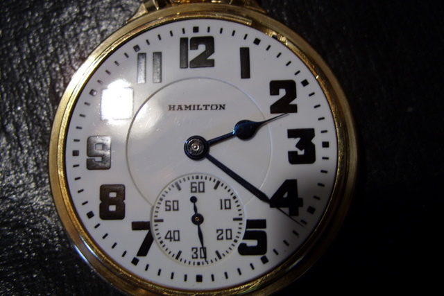

I'm sure this dial is right, but...

That is a genuine, original porcelain-enamel dial that is entirely correct for the watch. Hour and minutes hands may be replacements but seconds looks right. That all helps when beginning to establish whether you have a correct original or a sadly altered item.

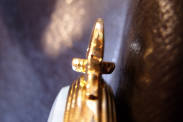

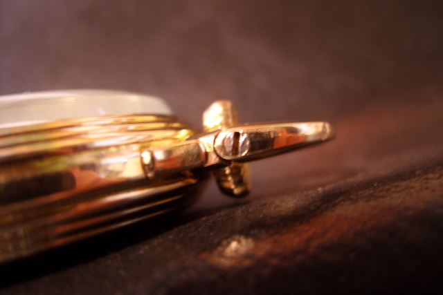

I'm new to Hamilton's and have the #10 case for this same watch in front of me. The bow screw does not look gold. That just doesn't ring true to me,considering the quality of these cases. Am I right?
The screw is tool-marked also-in case that matters...Thanks.
Marty
June 11, 2008, 17:20
Marty Bell
The screw looks gold in the light but steel in the dark-I'm very unsure-don't know if these will help-
Marty
June 11, 2008, 17:21
Marty Bell
And-
Marty
Marty Bell
Dang me-they look so gold in these pic's!
Marty

Compare the screw in your Model 10 to what you see in the Wadsworth Case Model 2 you see below, same "bar-over-crown" idea protected by the same 5-22-26 patents.
And yes, the screw should properly be steel...

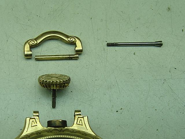

Hi Marty, I agree with Lindell, screw should more than likely be steel. I am working on a Model #2 case now and have it apart. Take a look at the picture there is a gold colored sleeve that the screw goes through.
Hamilton Model #2 Parts
June 12, 2008, 14:53
I recently took three of those BOC cases apart & each one had the steel screw Leon photographed.
