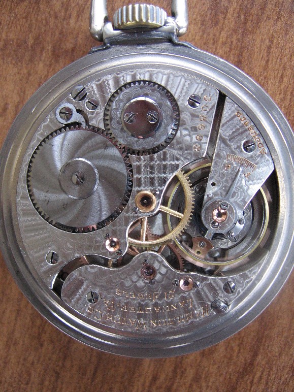

Steve GossardHelp with a Hamilton RR model
Here is a Hamilton #308,698. This number is not listed in Ehrhardt's serial numbers list.
February 18, 2009, 15:31
Steve GossardThe movement does resemble the grade 970 which is illustrated in the book. Is this a 970? The regulator spring is missing, and do you think the wheel has been replaced on the mainspring barrel?
February 18, 2009, 15:38
Steve GossardExcuse me. I found the complete chart. This is a 990. How do you think this compares to a 992?

Andrea SchiaviSteve,
this is a grade 990...
February 18, 2009, 15:39
Andrea SchiaviI think only 10,200 made in grade 990..

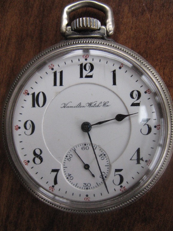

Steve GossardThis was my father-in-law's watch. He was wearing it when he died. It is important to me for more than one reason. Thanks, Andrea.

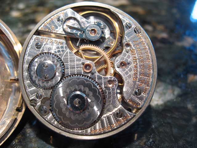

David AbbeYour watch is listed in the price guide as a 990. You can see the similarity to the Brand New one Lindell posted last year after he went back in his time machine to get it. Also the click wheel had been replaced on the one you picture.

Steve GossardI wondered about that. What are my chances of getting the correct one?
February 18, 2009, 15:52
David AbbeI think I have a regulator spring that fits that. As for the click wheel, as it is also in a major repair job case, if it was me and it was my Dad's watch I would leave it "as-is" as I am sure there is a reason behind all of it's "idiosyncrasies".

Tom BrownDavid
Do you know if it is possible that the wheel was put on upside down, I have never tried that but I wonder if someone could have done that.
February 18, 2009, 19:08
Steve,
Your father-in-law had excellent taste, evidently his daughter followed suit.

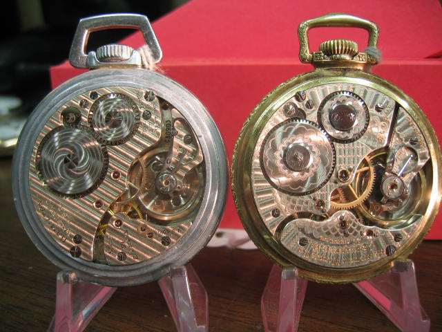

But seriously, my understanding is the Hamilton 990 was considered to be a somewhat higher grade than the 992 and today is far more highly prized by collectors.
The finish on that plain wheel is what we normally associate with lesser grades such as a 974 and we find this style were and are sold as replacements. It may be possible to find something closer on a parts movement or someone may have one loose. Tom's speculation is interesting and yes I have seen that done but this particular one is simply mismatched.
Good news, the whip-spring and screw will be fairly easy to find.

David AbbeIN my highly prejudiced opinion I think the 992 was a "cost-cutter" version of the 990

David AbbeSteve, I checked and I have some of those. It looks like the original spring attachment screw was broken off, maybe by the same BOZO who messed up the jewel screws. I will send you a new whip, but I recommend that you have someone knock out the broken screw and then clean and regulate this beauty. I will send the whip wherever you plan to do that.

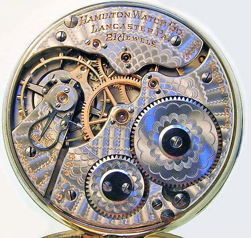

Charles J. BremNice one, Steve. Cherish and protect it.
Here's my 990, it's a bit later than yours. I love this craftsmanship!

Steve GossardBeautiful watch! Thanks. I wonder if they started making this grade before they made the 992.

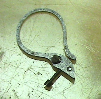

David AbbeSteve, By the looks of it, I think the 990 came first or was (at least) a "premium" 992 type movement!
For the parts (I added an assembly screw that fit a 990 here tho it is not the "rounded head" kind), please e-mail me your address etc to david@glopar.com and then after you get the parts just donate whatever you think it is worth to the IHC185 legal recovery fund. (It's a little dusty, but it will shine up fine)
