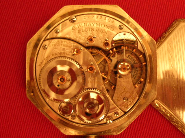

Hi
Just picked up this B W Raymond, 12size, jewelled barrel, grade 193, model 3, serial #17792182. Any help on the missing screw?
August 16, 2008, 00:47
Keith, these small screws can be a real bother, they are about the same thread as many jewel mounting screws, so if the threads are good in the screw hole, you might try some Jewel mounting screws from any Illinois 16s or 12s watch. The 2 wheel mounting screws you have look slightly bigger than the balance jewel screws on that watch so they could accept 16 size instead.
After all that babble, maybe Brian or Bryan can be of help.
August 16, 2008, 10:20
Keith Klimkowicz
Thanks David the 16size jewel mounting screw worked. Looks great now that it is complete. Just one more question which I know has been asked before. An I.W.C.Co. Supreme marking on the case makes it a gold filled case?
Thanks again for the helpful hint.
