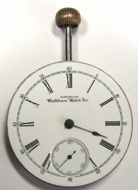

Your first guess is right Dave a model 88 fits perfect once I removed the stem and sleeve. Someone must have put it together at one time to try and put another movement in it. Now I have a nice case for a model 88. Just have to find a proper stem and crown. THanks Dave!!
tymekeeper005
November 14, 2011, 03:40
Robert V. Jones
You can see the movement fits just right and the screw mark lines up. I did some digging around and found some model 88 stems and then did more digging and found a crown to fit. Now I will keep it aside until I find a nice model 88 to put in it. Thanks again dave. Big Grin
