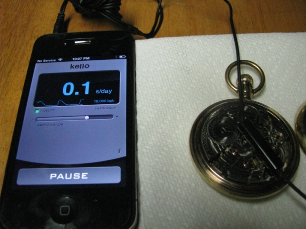

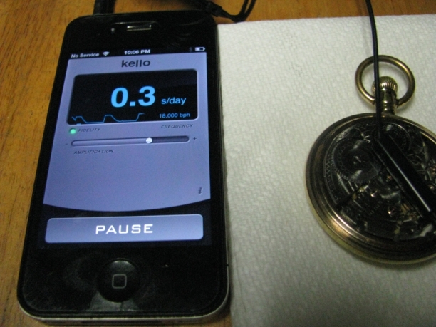

I recently download an app for my i-phone that some my find helpful and/or fun. It is called Kello. "Kello analyzes the precision of mechanical watches against the iOS system clock using a microphone." The app has an frequency autodetect or you can choose from a menu that starts at 14400 and ends at 36000.
Pictured is my i-phone, ear buds with a microphone and a Walthem 19j 645 that I recently cleaned and oiled that had been running 10 seconds fast per week for the last 2 weeks in the pendant up posistion. It is now timed by Kello in the face down posistion because the mic is cheap and has to "lay" on the movement for a decent signal. I will be looking for a stand alone mic in the near future.

Gathering Signal Data

Results
Results
December 07, 2013, 23:01
Michael Weiford
The signal data is updated about every 1.5 seconds. The results on this watch was between +0.9 and -0.6 consistantly for about a minute, so I figure I can take an average of +0.2 seconds a day.
