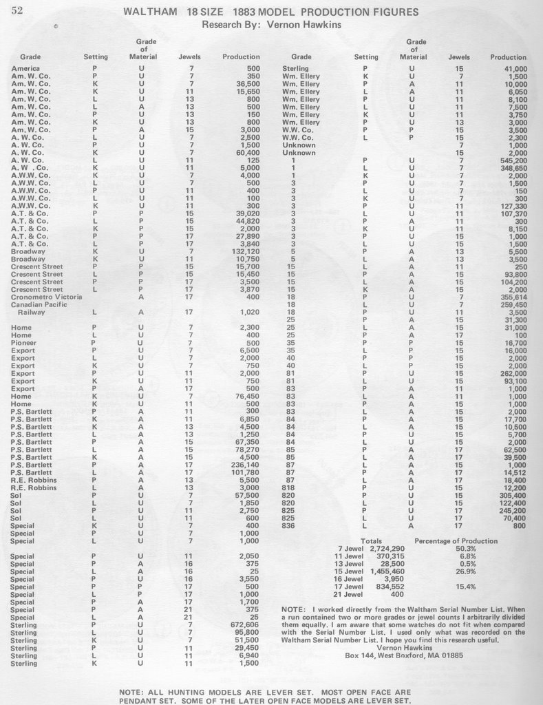

The Hawkins report claimes 4500 Key Wind model 1883 were made, and the waltham book shows this as part of a 1500 piece Key Wind run.
It could well be that Waltham revised some of those to Pendant Winding, Lever-Setting watches, or it may have a commercilly availabel conversion. The commercial conversion would make it very desirable indeed. To find out what is going on would necessitate lifting the dial.

David what is the harkins report I never heard of it before.
January 05, 2009, 23:05
as below;
