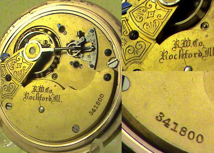

Bila, serial numbers and/or pictures always help. My Rockford factory parts and movement book suggests this is a model 7 with a similar appearance to the 15J pictured below. That would mean that it has a countersink in the top plate to clear the low mounted balance wheel, possibly a "switchable" Pendant/Lever setting mechanism (not on 15j shown below) and the somewhat complicated "Rockford" micro-regulator. As these 7th models were late 19th century, I expect the actual RR use certification would be up to the inspector at the time.
