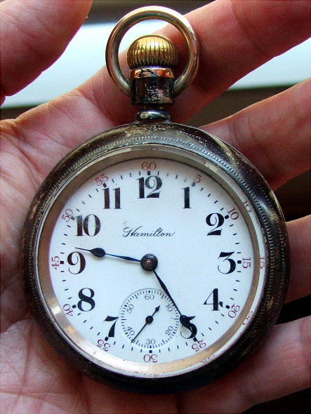

But... Monday morning, I'm again at my bench with the opportunity to dissect watches. First, on the list is a simply horrid acquisition that has potential...
It is a ho-hum Hamilton 924 in a 4 oz, Sterling silver, CWC case. The excitement is the case. 4oz cases were not the norm and sterling cases were quite unusual.
The best part is that I bought this for a song on ebay because it was so incredibly ugly. You'll soon see why. The case is old and very high quality but totally neglected and abused. It has a very low SN and that number is repeated 5 times on all the watch parts (bezel, back cover, bezel ring, and twice on each of the flip-out rings).
The bezel is interesting as well because it holds the crystal with a threaded bezel ring rather than with glue. I'm told that this is quite unusual.
But first, scroll down to see why it was so cheap. Not only was it incredibly dirty but I now know that it was PAINTED black as well. I'll try to post "after" pictures as the restoration progresses. Today, I dismantled and cleaned (ultra-sound and buffing) the paint off the case. I also replaced the cyrstal which was ok but has some tiny scratching. I chose the thickest one that would fit. I also disassembled the movement and cleaned that as well. It now awaits oiling and reassembly.
But, now... here's a really UGLY watch!

Peter S. BalkanThe Hamilton 924 and the 4oz,Sterling Silver case were finished today. I’ll just post one photo now and perhaps more later.
The movement was oiled and reassembled but more on that later.
The case was also reassembled after cleaning. It presented me with a number of compromises but I was adamant about replacing the worn, brass crown. In my opinion, nothing looks better than a sharp crown. We searched literally hundreds of old crowns to find just a couple that were large enough to fit the pendant. Then, of course, the likely candidates did not fit our stem. So, we began another time-consuming search for a stem…. which, in turn, had to be cut to fit. The new crown really “finishes” the case.
Cases look deceptively simple but I have spent many long hours trying to find case parts and fit them. In my opinion, a pendant sleeve is one of the hardest parts to locate and fit. I’ve also made more mistakes in casing watches than I’ve ever made working on the movements. It’s always heartbreaking because casing comes at the end of a project, just when you feel you are about to succeed.
I had to compromise on the NOS crystal. The ultra-thick crystal, I chose proved to be too thick and it hit the dial even before I set the hands. With quite a selection of thick NOS crystals, I found that the original crystal was my best bet. It was not in bad shape but I longed for a NOS one.
Lucky the 924 movement is lever-set… making the installation of the sleeve and stem much easier than in a pendant set watch.
The end product is quite spectacular by comparison.

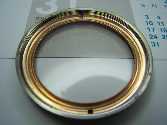

Peter S. BalkanI thought I'd post one more picture showing the unusual bezel and the "retaining ring" design for holding the crystal. I've never seen this system. The ring was quite delicate and difficult to work with. It had to be held completely level to screw in, like a case-back or one would risk cross-threading. But, unlike a stiffer bezel or case-back, it was far more delicate. We had to "invent" a tool to do it. Our "tool" consisted to two staking tools held vertically in a small vice at exactly the proper distance to engage the two detents in the ring. The the assembly was turned upside down and the ring installed. Otherwise, it seemed impossible to get it right.
The case, including the retaining ring, has matching serial numbers.... five of them.

Jerry TreimanThis is the wrench used to remove the reflector on these patented 18-size silver cases so that one could change the crystal. The label reads:
"This wrench is to accompany the Waltham Patent Dust Proof, glass bezel, now being introduced on Waltham Screw Bezel Cases. It holds the glasses firmly and closely, absolutely excluding all dust and moisture, without the use of cement. It will permit the use of several different sizes of glass. It is the only perfect Dust Proof Glass Bezel ever made. It will be recognized by its Gold Reflector."
I have seen this reflector ring on Waltham and Crescent cases.
