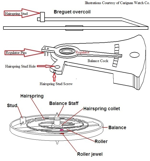

December 27, 2010, 17:13
Robert V. Jones
Bud the hairspring stud is held in by the screw and the hairspring is suppose to float in the pins

Bud, at the bottom of the page, page 56, it actually shows a picture with a description of the hairspring stud and it's location on the regulator....the hairspring stud is what is missing or broken in Rob's photo....so the hairspring is just held in place with glue....

Richard Romero
Bud,
The regulator on mechanical watches works by making the EFFECTIVE length of the hairspring longer or shorter. This is done by the regulator pins getting closer or further away from the hairspring stud which is held stationary in the balance cock. The hairspring passes between the two regulator pins.
If you notice the hairspring originally posted is glued directly to the regulator pins thus rendering the regulator useless and eliminating the hairspring stud.
