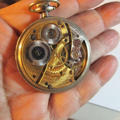

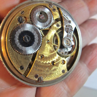

Andy SchwartzHELP IDENTIFY
WHAT IS GOING ON HERE
GOLD TONE 2/3RDS - NOT GILT
22585365
Grade: No. 620
Movement Serial Number:22585365
Estimated Production Year: 1919
Run Quantity: 5000
Jewels: 15j
Movement Finish: Unknown
Model: 1908
Movement Setting: Pendant
Plate: 3/4 Plate
May 17, 2013, 20:39
Andy SchwartzWHAT IS THE DEAL WITH THIS?
THANKS
ANDY
May 17, 2013, 20:56
Edward L. Parsons, Jr.Andy,
Is the balance bridge supposed to be not gold-flashed or did someone just switch it out?  You could check the numbers stamped on the back side to see if it is legit.
May 17, 2013, 21:05
Andy Schwartzed, if I take it out adios watch....I will call dr unselt... what is with the gold flashed?
May 17, 2013, 21:10
Jon HartAndy,
Your movement is correct
 - everything but the balance cock is two toned...
Movement alone 60-80$
Is there a drilled hole on the winding wheel - looks odd
May 17, 2013, 21:25
Andy Schwartzwhat do you mean by current? correct?  is there any value?
May 17, 2013, 21:40
Peter Kaszubskiits all good and correct Andy
its 2 tone Waltham
just not sure of the small hole on windind wheel
May 17, 2013, 22:39
Gary E. CochranAndy,
Your watch looks correct...I have had several over the years...The winding wheel just needs the washer that goes under the screw..I have some at home if you want one let me know and I will send you one on Monday..
May 17, 2013, 22:54
Andy Schwartzwell, let me ask this....you guys want this bad boy here?  I think the dial has no lines and it is in a 25yr challenge case that is nice, wgf.
please let me know, I will do it with no reserve if there is desire. then the washer can go to the winner. Thanks so much Gary!

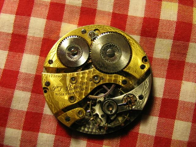

Kevin MoodieAndy,
Here's a P.S.Bartlett in the same colors.
