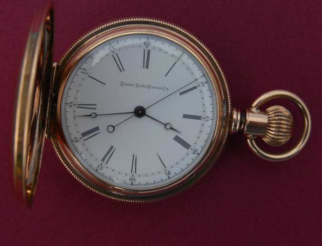

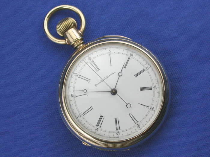

For those of you that remember earlier posts about my Elgin doctor's watch, you will recall my vain attempt to restore this watch and fit it to the original case.  I purchased it on eBay about two years ago in shambles.  It had a loose dial, bent hands and filthy movement but it was original and complete; I thought.

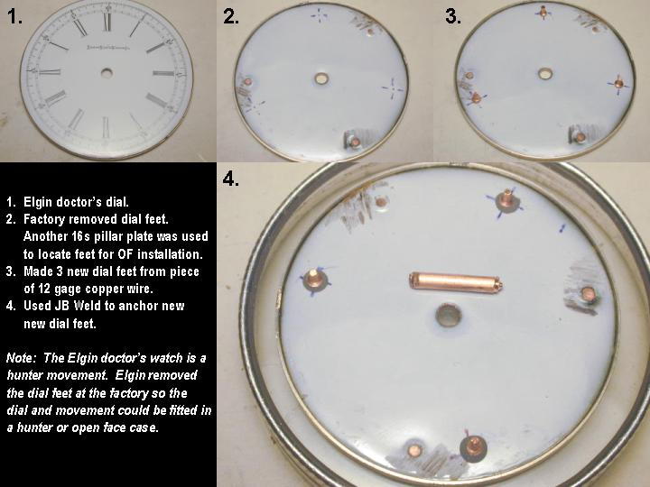

After repair and cleaning of the movement, I attempted to fit it back in the case.  This is where my nightmare began.  There was no lip on the case to catch the pillar plate.  The only thing keeping the movement from sinking through the case was the dial.  The dial on these movements had the feet removed at the factory.  A metal ring was fitted around the dial, which was supposed to snap onto the pillar plate.  However, when the movement was installed, the dial simply pulled away from the movement.  To fix this, I machined new feet out of 12 gauge copper wire and JB welded them to the dial.  I lightly torqued the case screws so as not to damage the dial and thought this would work; it didn't.  After a few days, two of the feet came loose, which caused the movement to pull away from the dial and shed the hands.
I gave up and put the watch away in the drawer.  Sometime later the subject came up in an email with Steve Maddox.  After describing the watchcase to Steve, he was positive that the case was missing a spacer ring.  I searched high and low for a 16s JAS Boss spacer ring with no luck.  The watch was returned to the drawer.
While visiting Lindell last November, we discussed the spacer ring issue.  Lindell came up with an 18s spacer ring that he thought might work.  I cut a small section out of the spacer ring and it compressed to fit perfectly in the case.  I reattached the dial feet, installed the dial and attempted to install the movement.  Well, it wouldn't fit.  The spacer ring was too thick.  Again, the watch was put back in the drawer.
About three days ago, Lindell called me at work and the watch came up in our discussion.  He asked me how the watch was coming along.  I told him it wasn't.  We talked about it and he asked if I could file the ring down to fit.  I told him the watch was doing just fine in the drawer and was inclined to leave it there.  He offered to send his Elgin doctor's watch to me which had a similar case so I could estimate how much to file off of the 18s spacer.  I declined his kind offer and decided to leave the watch in the drawer until I could find the correct spacer for the case.  Well, Lindell peaked my interest again in the watch so I pulled the watch out of the drawer and started filing, filing and filing on the 18s spacer ring.  It took me nearly two hours to remove .032” of brass from the spacer.  I know there’s a better way of doing it but all I had at my disposal was a file.
My doctor’s watch is now back together.  Many thanks to Steve for identifying the missing part and to Lindell for supplying a spacer ring.  An Elgin doctor’s watch with the proper hands and original case is a rarity.  I haven’t seen one on eBay for quite sometime.
I will now continue my research of the original owner.  The watch came from the estate of Dr. Edmund T. Glessner, D.D.S. who died around 1963.  It belonged to his father who was a Medical Doctor that died in the early 1920’s.  I believe both father and son had practiced in Colorado.

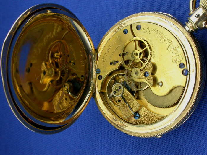

January 09, 2004, 09:49
John D. Duvall Note the matching moon hands and hinged front bezel.John D. Duvall

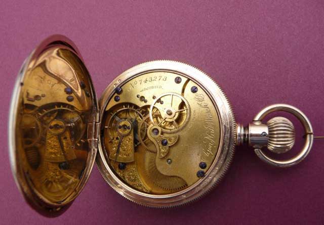

January 09, 2004, 09:54
John D. Duvall I also had to fabricate a tension (anti-backlash) spring for the seconds hand arbor.  A tiny section from a 16s hairspring was used for this purposeJohn D. Duvall

January 09, 2004, 09:58
John D. Duvall Note how the Elgin factory cut the dial feet off.  Talk about botchery!John D. Duvall

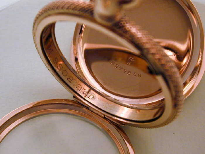

January 09, 2004, 10:03
John D. Duvall Note the spacer ring stamped "JAS BOSS".  This is what was missing from my case.Photo courtesy of Lindell V. Riddle.John D. Duvall

First, the dial feet are a neccessary part of making an enamelled dial.  Without the feet, the dials would stick to the furnace rack.  For a long discussion on how Elgin made dials see
The Building of the Watch: The Dial DepartmentSecondly, "doctor" watches really aren't hunter case watches since the second hand is in the center.  By using a snap ring with instead of dial feet, this allows the watch to be placed equally well in either a hunter case or an open face case.
Actually, from what I can tell, "doctor" watches really weren't designed for doctors, but rather, they were a cheaper way of making "convertible" watches.  At the time that they were introduced, most watches were still keywound, and KW watches can be placed in either HC or OF cases.  Both the Elgin convertibles and the "doctor" watches were an attempt to keep this desirable feature of KW watches.

John D. DuvallWayne,
Do you know how or where the dial snaps to the pillar plate?  It's still a mystery (misery) to me and I've had this thing apart too many times for comfort.  I may still take Lindell up on his offer.
Good point about firing the dials.  I just wonder why they did such a rough job of grinding off the feet.  I guess it was an area that is hidden from view.  Still, it wasn't very becoming of a watch company to leave such sloppy work behind.

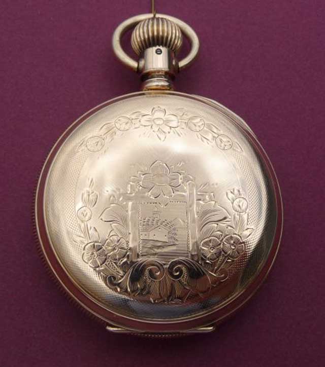

Steven FordHi John,

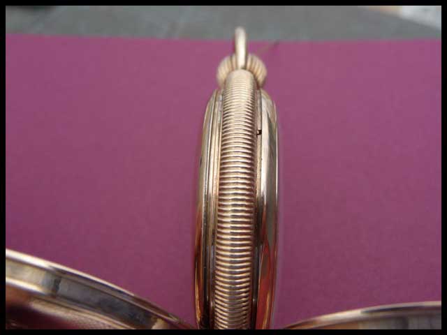

It's been a while since your post, I hope you still have it. There seems to be so few of them around, and cases are hard to find. I got mine with a Granger BWCCO Hunter case With extra deep bezel and dust cover that looks like it was made for it.
Here's a side view of the case.

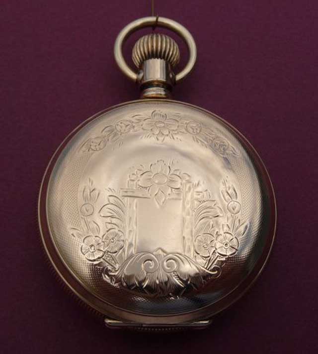

July 04, 2010, 18:01
Steven FordAnd back.
Just wish I could find some more!
