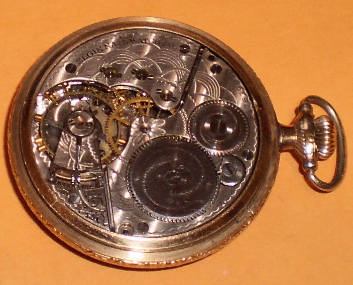

Sorry I wasnt clear, Its an Elgin. Of the 6 watches I have 5 are Elgin and ones a Waltham. Here are the pictures. But what I am thinking is that the square post is to short, because when I get the crown tight on the shaft it doesnt pull out any more.

The watch that you are showing appears to be a stem set watch. I see no lever that you pull out.
Which means that the watch will have to be tight in the case to wind set correctly. If you shake the watch back and forth as you look at the back off the movement the Balance wheel should swing back and forth. If it does not then It will probably not run even after you get the movement secure in the watch. After you get the movement secure in the watch if it does. With the stem in the down position. Closes to the dial or hands. It should wind or put tension on the mainspring.
A-If it is wound tight then it has a mechanical problem. Needs cleaned and oiled. Some times called serviced. Should be done with someone that is qualified.
B- The watch winds and never gets tight. Would be diagnosed as a bad mainspring.
C- The watch winds tight then when you shake it [ Balance does not spin back and forth} Could mean Needs serviced, Balance is broken. Or many other things.
Any time I buy a watch. I first check that Balance has motion. Then if the mainspring is good. Tighten when wound. Then if balance will swing by itself. If balance has good motion. If it does not have good motion it will need serviced. Then if hands set correctly.

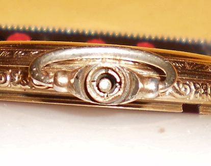

Jim it sounds like the stem and sleeve needs an adjustment to be able to "pop" in our out from the winding to the setting position. This requires a sleeve wrench once the crown is removed from the stem. When you remove the crown, take a picture looking down into the stem cavity so we can try and tell if there is in fact a sleeve, which will be required on/in the case for a pendant set operation.

Thanks for that bit of info Eugene. As I can see, the watch fits the case. I have attached a picture of the movement in the case. The balance moves, I can even wind it a little and see the balance move and the watch tick. But I think the stem is the issue.

Here is a picture of the stem cavity with the crown removed.

Jim there is in fact a sleeve in the pendant and it is set up for a pendant set movement. The four divits set 90 degrees apart are for the prongs of a sleeve wrench to adjust the sleeve up/down to be able to make the pendant set case work for individual movements. Sometimes you can fit a small blade into one of the divits and screw the sleeve up/down to get it to the right position for your movement. This is a trial and error procedure for the particular movement. First get the stem in the case where it does "click" up/down. Try half a turn [180 degrees]until you get it right. Once right put the movement back in the case and try the winding/setting again. It may require a little more sleeve adjustment to get it correct. Just keep trying the procedure and perhaps you can get it to function correctly.

Thanks Buster, I have managed to get the sleeve to move and I am going to see if I can get it to work before taking Roger up on his very kind offer.

What I ended up doing is this. I took the sleeve all the way out of the watch, and noticed that it was possible to over tighten the crown down on the shaft to the point it didn't pop up any more. I think this was the real problem.
I needed to make it so the crown only screwed down so far onto the shaft. I had a small strip of aluminum left over from the packaging of a shirt sitting on my bookshelf. I cut a real small piece off of it and fit it into the crown so that the shaft now only went in so far and would not over tighten.
I played with the sleeve a little to find the correct depth, and checked that the watch wound easily. As I am writing this it is ticking away.
