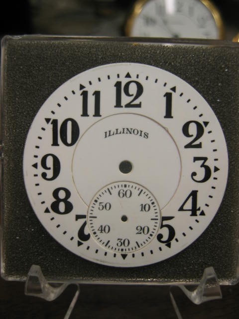

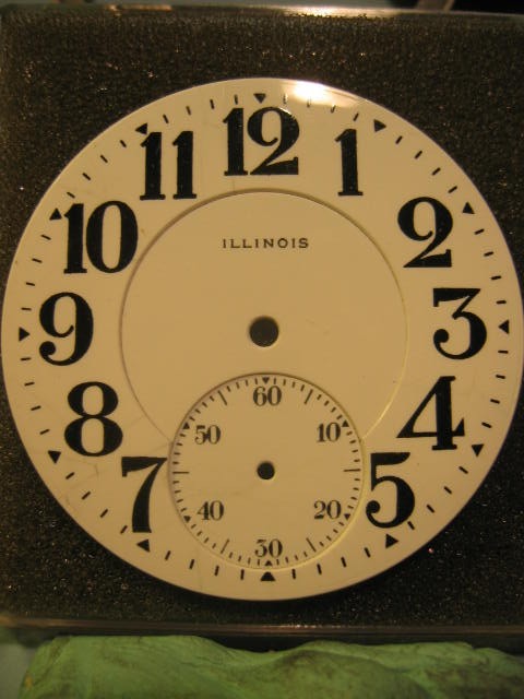

Steve, We may be ab le to help each other I have this dial . . .

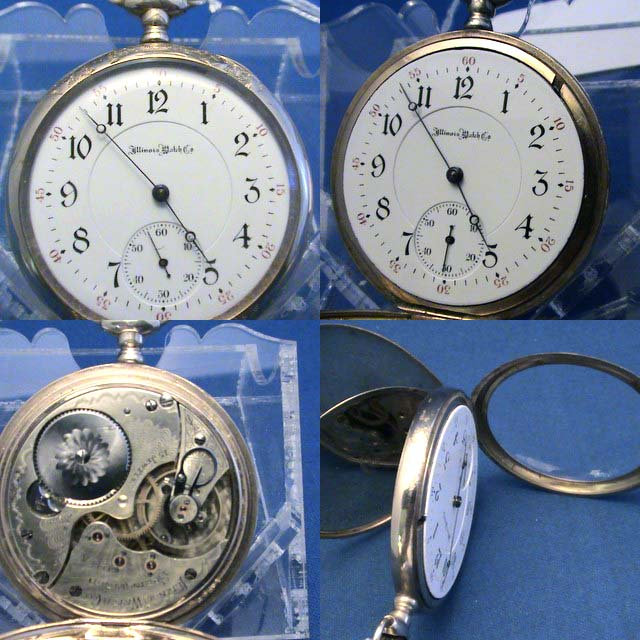

and this dial . . .

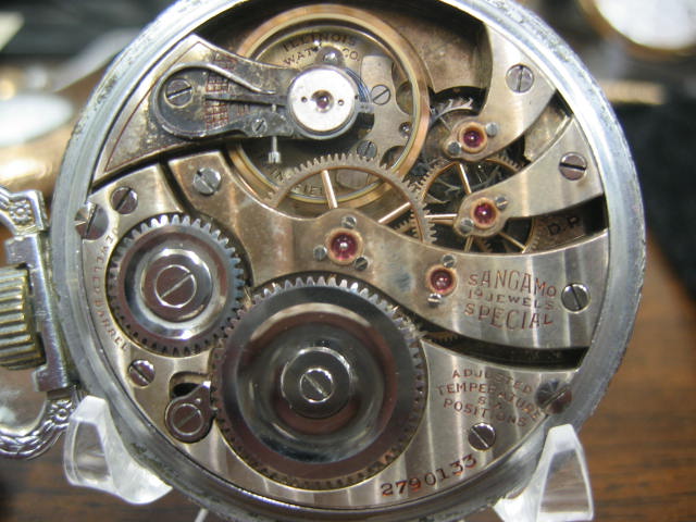

Which is on this watch (after the original dial was stolen by a guy in Missouri was was going to "fix it")

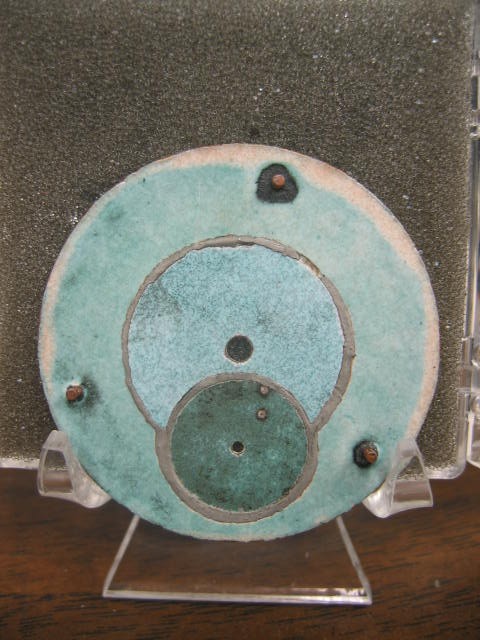

If you look at the Sangamo, it is missing a decent Case. I need a decent case, and you need a decent dial. I can probably help you with the dial of your choice if you have any way to trade me for a decent case. (btw I have $150 in the unmounted dial, and would be happy to pick up the difference to find an authentic case. Backside pictured)

The second watch, the Sangamo, looks like it is the identical dial only in much better condition than mine obviously. While researching you movement it is stated that your movement could have had several dials used including bold or regular Arabic,Gothic style Arabic, and montgomery numerical. Also, they were sold as movement only as the Sangamo was not factory cased until the Model 10 came out. This being said, the only available case I have is a B&B 20 year model in decent shape that the watch would fit into but whether it is period correct I don't know. I can email you pictures or even send the case to you if you will get the information to me. Let me know.

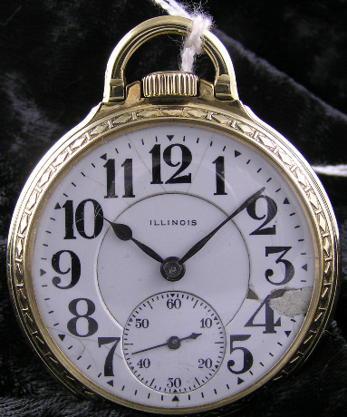

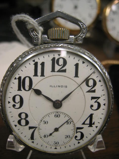

My latest acquistion came back from repair and cleaning and thanks to Dave Abbe having the exact same dial to replace the totally destroyed one that was in it, it now looks very respectable. It's a 16 size, 23 jewel, Model 9, Bunn Special, manufactured in 1915 with only 2,470 made with the gold lettering. Runs great and keeps good time.
From the Front...

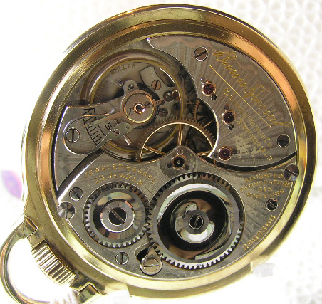

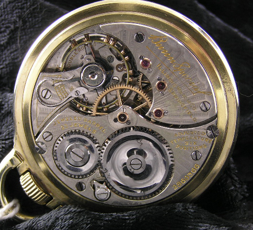

and the movement...

Looks like a great improvement Steve!
"I get by with a little help from my friends" ...comes to mind.

It seems that some parts were also replaced...balance cock. It doesnt seem to match the original watch.

Mike,
What an eye you have. I sent a 21 jewel 60 HOUR Bunn Special along with this one to get repaired as well and he switched the balance cocks. Now that is just great....I get to pack them up and send them back. Thanks for catching that and I am glad I posted the follow up. The sharp eyes of ihc185 come through again.
