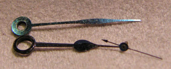

Here is a picture they are not the best but no rust

The hour and seconds hand are correct; that "reverse-arrow" second hand is actually for the higher-end watches and is therefore more desirable. The ball-end seconds hand was for the 7-jewel stuff like the Model 8.
The minute hand belongs on something else.

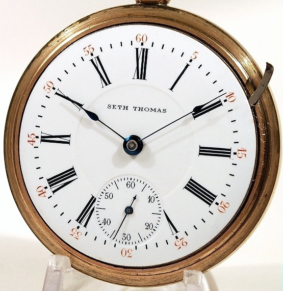

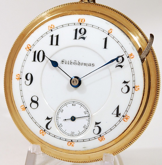

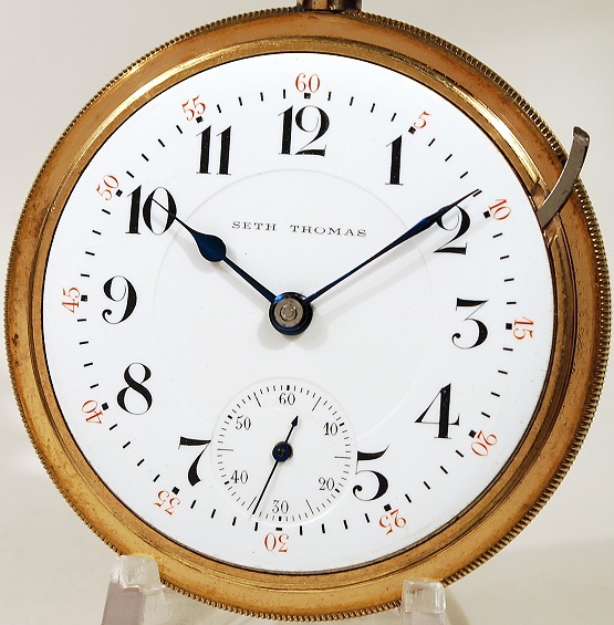

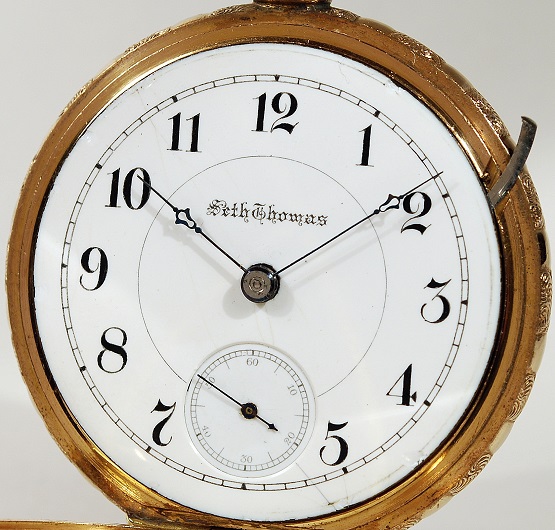

The hands will fit any 18-size Seth. The tolerances were never that close, so it may be necessary to close or broach the hands slightly.
The light spade hands should go on anything with a Roman dial:
November 13, 2013, 22:53

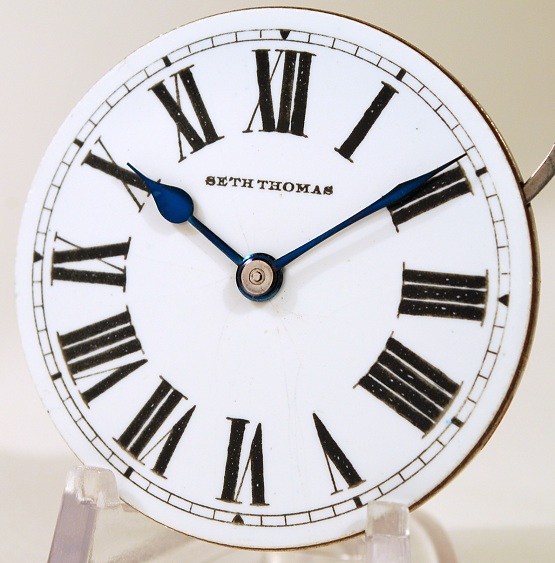

Eric Unselt
Rob's medium spade-and-poker hands should go on an Arabic dial:

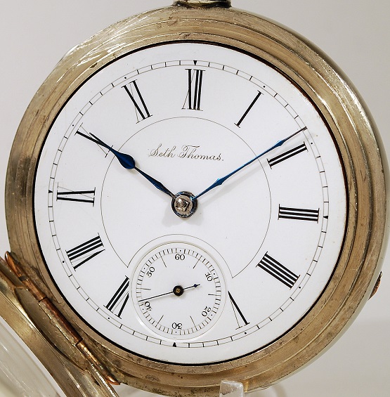

Eric Unselt
Heavy spade-and-poker should go on the heavy Roman dial:

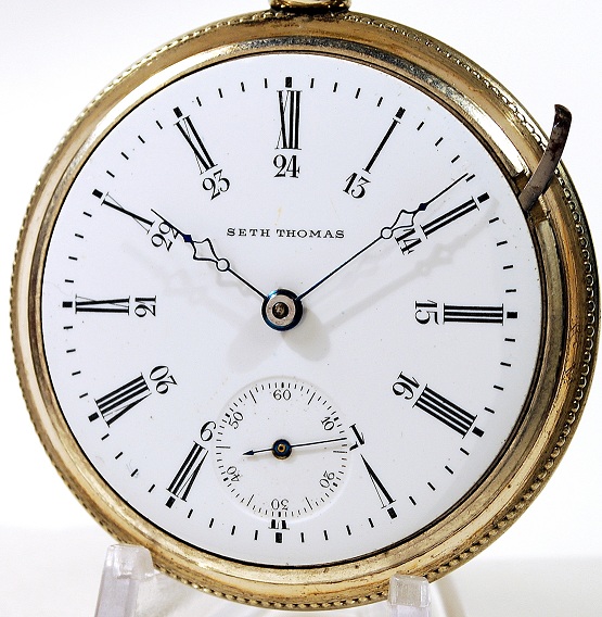

Eric Unselt
The open-kite are usually seen on the 24-hour Roman dials:
November 13, 2013, 22:57

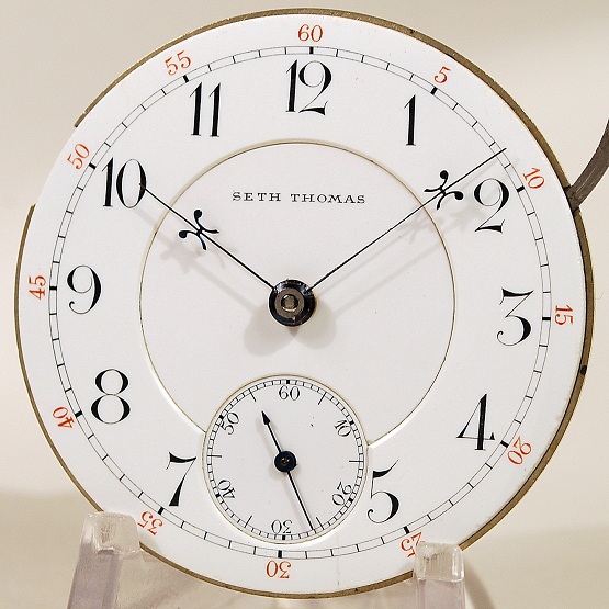

Eric Unselt
And fleur-de-lis hands for the light Arabic dial:

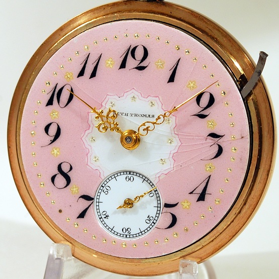

November 17, 2013, 22:49
Eric Unselt
There is a third style of medium spade-and-poker hands - a slender, more tapered style reserved exclusively for the Maiden Lane and the legendary double-sunk red/black Gothic Arabic dial:
