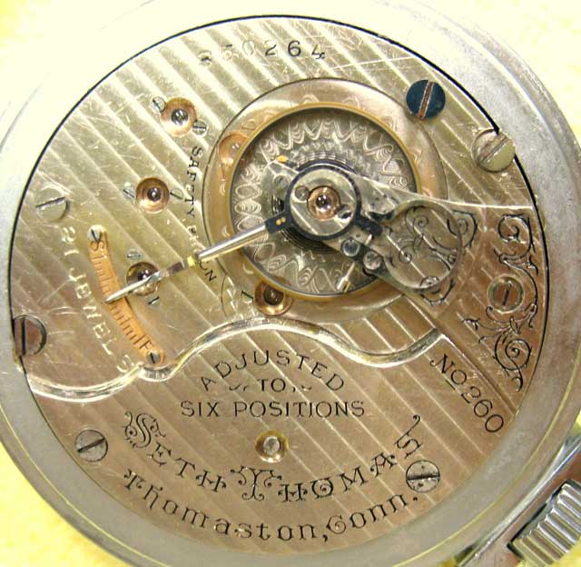

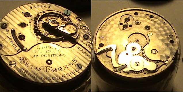

Well, I guess it was just because I wanted a Seth Thomas model 5 for comparison, but I got one, and it needs EVERYTHING.
I think it needs a Balance Staff, Center Wheel, and hour wheel!!! and it doesn't look all that great either, but hey, I'm for the underdog anyway, so I got it. Pretty cheap, so no real loss. Think she can be repaired?
SN 350264
350264 ctr whel balance hr wheel needed

Sheila your thread answered my prayers for you and I hope that all goes as well as possible for the next steps in Russell's recovery. Shugart lists a S.T. 260 at $400 - $800 which suggests some considerable value to get it together. It looks like the regulator whip is missing too. When you refer to the "Center Wheel, and the Hour wheel" do you mean the two wheels that go under the dial? Those top wheels are much easier to find (I may have them here) than a Main wheel for a rare 21 Jewel watch like this because they were pretty common to all different jewel count movements.
For starters, maybe we should make a "list" of actual parts needed. The see what can be done to resurrect this.

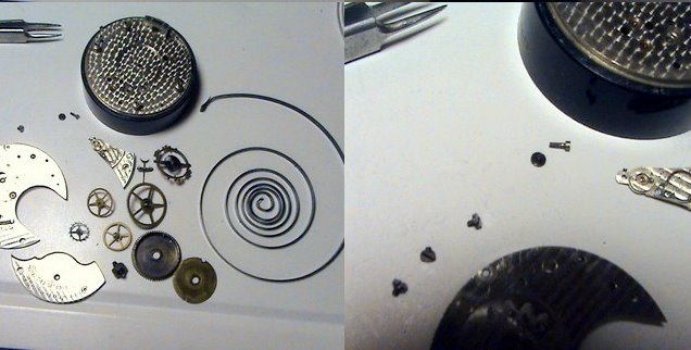

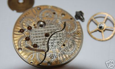

Sheila Gilbert's Seth Thomas has arrived for restoration! For all concerned, Sheila has agreed to let us try to bring this 21 Jewel model 260 beauty back to life! It arrived today from Sheila as pictured below, and Brian C. and I have agreed to make this a "project" for Sheila. I will start a new thread as we progress to bring all of you up to date on this very fun and important restoration of a fine Timepiece. Hmm, on first look, it needs a Balance staff, Main Wheel, Cannon Pinion and Hour Wheel, some screws, a Dial, Hands, a Case (Sheila how about that 18s Silveroid you posted recently?).

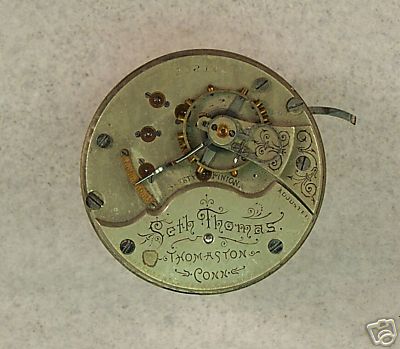

I also have another Parts model 5 Seth, that maybe I should have sent with this one, but I didn't think of it. I will check and send you pictures, so you can tell me if it's one you want to consider for parts. I also have many cases, but you will have to walk me through which one I will need for it.
I found the picture.
The SN on this one is 208146
Below is the parts watch I have, and it needs a staff too, so that part won't help, but maybe others will?
208146 Seth
Sheila

Sheila Gilbert

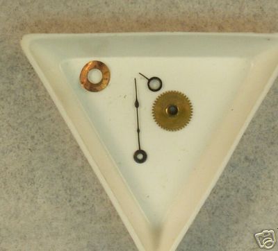

These are the parts that came with it, and it even RUNS!!! ??????????????
208146 Seth3

Sheila Gilbert

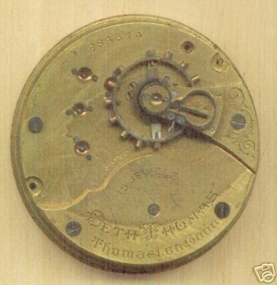

I have another one, SN 284674 but I can't find it.
I will have to take a few more things apart and let you know on this one.
ebay picture.
Seth-284674

Sheila the early model 5 you have that has a broken staff "and runs!" deserves a chance at being restored too, the other 15 jewel seth may have some useful parts if you find it let me know. Also, Brian C. has stated fairly clearly that he has parts enough for this but we have to compare notes later this week about what is really needed.
May 28, 2008, 17:23
Sheila, after taking this apart, I definitely could use the 15 Jewel you have if you can find it.
May 28, 2008, 21:06
Sheila Gilbert
OOOOOOOoooooo look at that! all apart!

PS I picked up the watch that had the parts with it, and while it was face down it started ticking, of course I thought it was another watch I keep on my desk, but SURE ENOUGH, it was the watch!!!! I didn't think it could do that.
I have no idea what the parts that are out of it are, but I thought with missing parts like that larger one, it couldn't run? Do they do that?
It only ticked a few times, then stopped, then again and again, so then I put it to my ear, It was the watch for sure, I couldn't believe it.
Wish I knew them better, then I would know what is normal.

So Far these are the parts we need;
Regulator for this model Whip style
Balance Staff
Main Wheel or staff
Cannon Pinion & Hour Wheel
2 more matching Movement Screws
Good Dial and Hand Set
Decent Lever-set Case.
It's really amazing that all the Jewels are good, and most of what is needed besides the above list might be to better screws that would clean up, and most important a GOOD Seth Thomas Dial. I will check all my stuff for a Dial, and I am sure that Brian is doing the same.

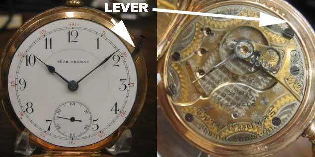

The lever set case needs to fit the seth and have the lever slot in the rigtht place for the seth lever, and you do have that nice 17 jewel movement with the lever to check that out.

I have no idea where the lever goes on the one I sent you. I'm like a 2 year old when it comes to all this. It's the one time I'm really lost.
Below is an ebay photo of the other watch I mentioned. 209255 but I think the wheel is missing, unless they put it back inside the movement. There is one wheel in there, and all the jewels look intact, but that's all I can tell you except the other 2 parts are included. I will send it out to you on Monday.
I'll check all my cases and see which ones have the lever cut out and take it from there.
I will also get a photo of the lever on this watch and post it tomorrow.
Seth 209255- mine
Sheila
June 01, 2008, 14:20
Sheila, The lever case we need would also fit the other 17 jewel "ticks" movement you have which is nearly the same as one of my "complete" Seth's (see pic below). That "Wheel" you show in the last picture is the main wheel WITH a cannon pinion. Given that it fits our project watch that will help a lot as will many of the bits and pieces that can be "farmed" out of that partial movement. I could use the cock Jewel, but will do with whatever comes when I return home in mid-June from our fun Alaska cruise.

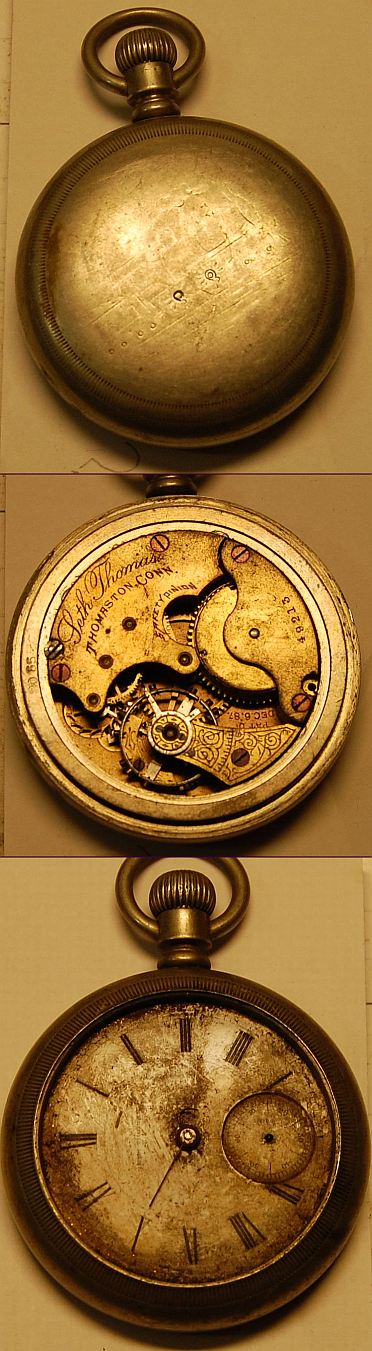

Checking through the old postings I found this heading - seemed to be the most appropriate.
Just got this "beauty" today. The balance staff is good! And the hands would set if the minute hand could clear the curled up hour hand stub! Smile I'm going to try and revive it.
I'll obviously need some hands and who knows what else. I'll most likely be posting in the WTB section before it's over.
Dave Turner

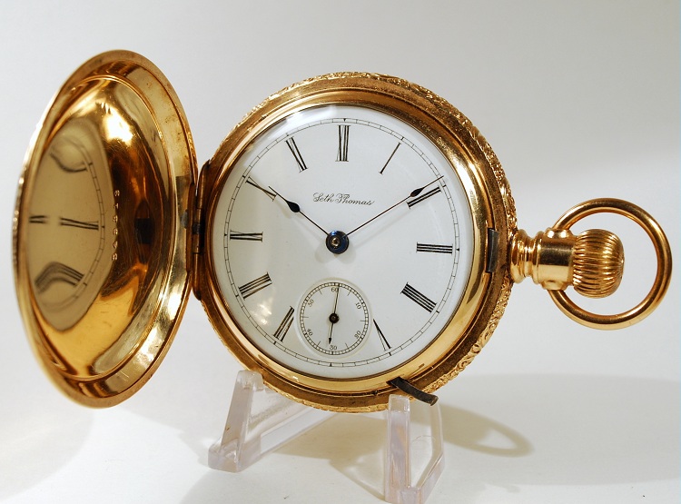

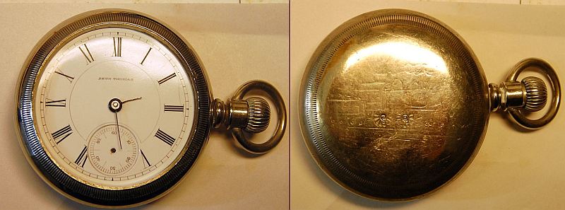

Dave, If you want, I can look at helping revive your Seth, it took about a year for Sheila's. The following "caps" Sheila's Seth when it was finished;
posted June 09, 2009 14:48
The "Wrap" on Sheila's rescued Orphan Seth Thomas watch to restore it to where it is now took the following help;
Brian Cavenaugh;
Regulator Whip
Main Wheel with staff (Complete)
Cannon Pinion
2 Pillar Screws
Hour and Minute Hands
Hour Wheel to fit Cannon Pinion
Dave A.
Cleaning and restoration work
Base Metal Case
Regulator Adjustment Screw
Dial
Second Hand
1 Pillar Screw
re-staff and Poise Balance Wheel
Thank You everybody!

I wondered who got that one, Dave.

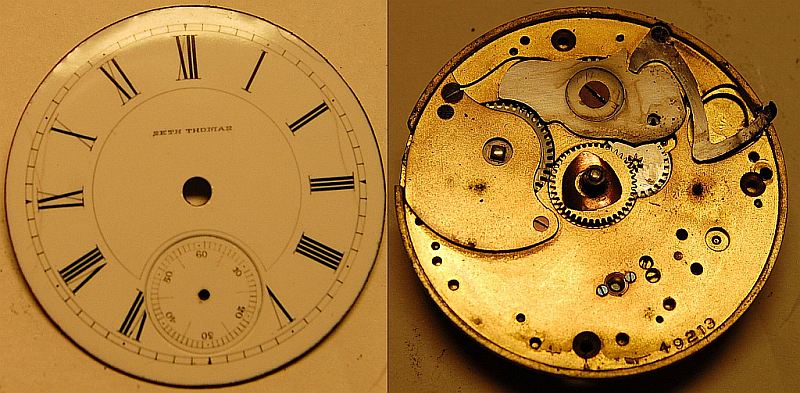

Here's the dial after a 2 minute cleaning and the faceplate prior to cleaning.
Dave Turner
November 08, 2013, 21:07
Eric Unselt
Everything under the dial is there, including the lever spring and the yoke spring. There's hope yet!
