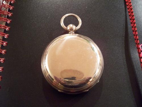

Here is the back

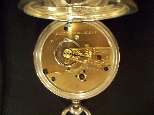

Here is the movement

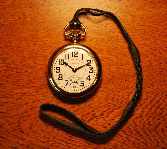

Bruce, I lean toward these simple braided-leather fobs for everyday carry watches. They're around 10" long, easily lace through one's belt, and can be had on eBay for less than $5.
The soft leather won't damage crowns and come in black or brown. I invested in several of these hours after my first Hamilton hit the ground.
