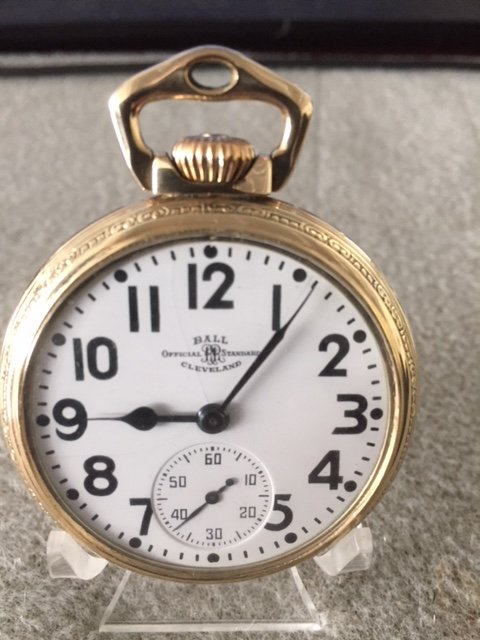

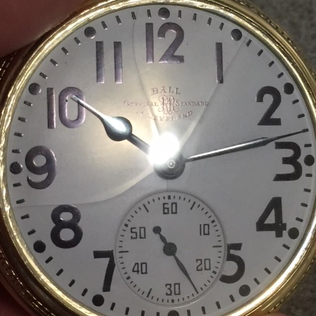

I purchased the watch 4 years ago, gave it a good look and all was good. About a year later I had it out and at the angle I held it with good lighting I noticed 3 faint lines from the centre of the dial to the edge of the dial. After a few profanities I wondered what went on there.
Here are a couple of photos as it looks now, the dial photos are taken at an angle. Too bad, nice watch and a good timekeeper. Line 1-btw 11 & 12 - line 2 at bottom of 1 and line 3 at top of 8.

Peter KaszubskiFew questions as the hairlines going from center not from dial feet position, could some one who did service press too hard while removing hands?,what temperature was the watch held at.
Or the age S#*% just happens and dials cracks.

Rick FarmerHi Peter, I suppose it could have happened during servicing but I don't think so, the fellow I bring watches to is experienced and have had no issues previously. As far as temperature the watch was not subjected to any wild temperature swings. I think it may be as you suggest..sometimes dials crack. Rats!

Larry LamphierRick, you are correct that "sometimes dials crack" However you will find that any Melamine dial will crack at random. I see the shinny ones like that one crack under the nice surface, but eventually it will come to the surface. I have about fifty of them that the dials have gotten so bad that they will actually stop the hands. I believe it will not be long and there will be no more melamine dials.
I took a NOS melamine dial out of the package, put it on the movement, and listed it on ****, the other site, and when I sold it and sent it to my customer, and it had a nice hairline between the 10, and the 11. They are just BAD dials!

Rick FarmerHi Larry, thanks for the melamine dial assessment. I think I'll wear it as a carry watch more often and enjoy it. Might get a few years wear out of it before it gets ugly.
