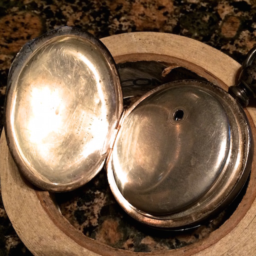

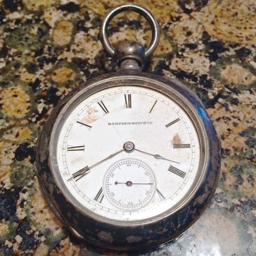

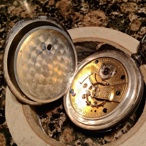

I had another chance to view the watch today. The case is a Fahys Monarch #R5415 (same number on all three parts).
Three pictures: in this post, the dial showing the decapitated crown. The next two posts are bad views of the back. Let's just say that the movement looks clean to me.
My theory remains that the crystal was broken long, long ago. Someone tried to replace it, failed, and put it in a drawer. It was found (along with the replacement crystal) recently. I'm betting that it was running find when it was put in the drawer and will run just fine after a COA. The only hole in this theory is the missing crown. Perhaps the mishap that broke the crystal also ripped off the crown (and, of course, perhaps did some internal damage).
A replacement crown would be most welcome! Then, it will most likely go off for COA+repair. And, of course, acquisition of the correct key.

Kenneth R. Sloan
2

Kenneth R. Sloan
3

Mark Cross
I'm a little puzzled at this, Kenneth, as keywind/keyset's didn't HAVE crowns. You wound them and set them with the key, so they didn't NEED one. It being an open face case, it also doesn't need a push button. Confused

Kenneth R. Sloan
Hmmm - makes perfect sense - except that I recall seeing a gaping hole where a decorative crown would attach. Perhaps I was hallucinating.
If so...huzzah! It's in better shape than I thought.
It's entirely possible that I formed the idea of a missing crown BEFORE I noticed that it was key wind/set.

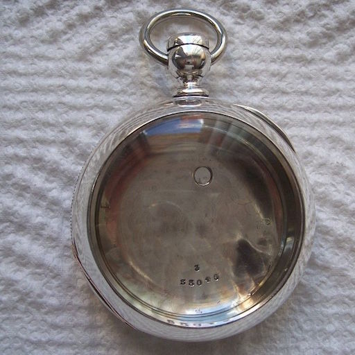

August 24, 2015, 13:42
Kenneth R. Sloan
Here's a vaguely similar case - note the "cap", which is missing on the watch I'm asking about. My recollection is that there is a HOLE (a big one) at the top of the ball.
alas, I'm now a 4-hour drive away from the watch - I have put in a request for better pictures.
Kenneth Sloan

Mark Cross
Many times those 'caps' were hidden keys to wind and set the watch with.
Regard! Mark

Kenneth R. Sloan
More and more interesting...
Assume (oops?) that this case does have a hole where a crown and stem (or cap) should be. Is it possible that this MOVEMENT has the capability of being either wound or set (in addition to the clearly visible wind/set mechanisms?)
Or, is it likely that the case simply wasn't a perfect match to the movement...had an extraneous cap...which has been lost?
If it were mine, I would probably look for a replacement case. But, this is my friend's "grandfather's watch", and he may be as attached to the case as he is to the movement. If that's so - what are the options for repair?
If my memory is correct that there is a gaping hole at 12, it surely can't be a good idea to leave it unplugged, can it? Or, does it not matter?
If I get better pictures of the top of the hole, I'll post. Until then, I remain puzzled.

August 24, 2015, 14:29
As this is an Open face case, there is little utility to the cap or "crown" except to plug the hole or for a "Hidden" key. I have seen these where a wood or bakelite plug was shoved into that hole just to keep the debris from "falling" into the movement. The Movement however usually has some sort of dust band too. In short, the movement looks very nice and deserves a full restoration along with a cleaning of the case. Then deal with the "crown" question.

Richard M. Jones
Kenneth, Dave and Mark are both right, but when you said crown I assumed you meant the small metal cap. You could replace the case if you wished.

Kenneth R. Sloan
I think we have consensus! Since the present owner of the watch is skilled in working in metal, he may take the opportunity to do something "creative".
I'm fairly certain he has no desire to replace the case.
so...COA, install appropriate crystal, and hope there are no surprises inside.
And then...deal with the hole. He also has experience in shaping little bits of cork to close holes...I think I feel a plan coming on.

August 24, 2015, 22:43
Ken, the way you got it is the way I would keep it. The hands are not matched, the Hour hand looks like it is the replacement and both of them look like 19th century manufacture.
It deserves a good restoration after waiting so very long to keep someone "on time" again!
