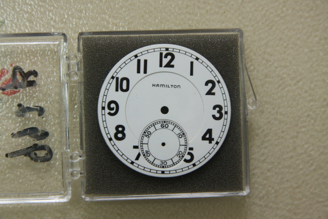

Here is the dial, to me it should go on a 950E around the 1937 time frame.

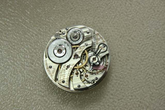

Larry LamphierFor this [shown below] movement.
I agree Dave, but this customer/friend tells me what he wants and expects me to be sure it is correct for the watch.

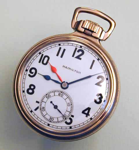

Edward L. Parsons, Jr.That's right Larry, it's the dial that came out on the 950 Elinvar Mainliner (circa 1937-1939).
The single-sunk version of the "track dial" (Dial 082) had a much longer life, in both enamel and melamine versions, including late 950 Elinvar Mainliners (circa 1940-1941).
Late 950E Mainliner with Dial 082

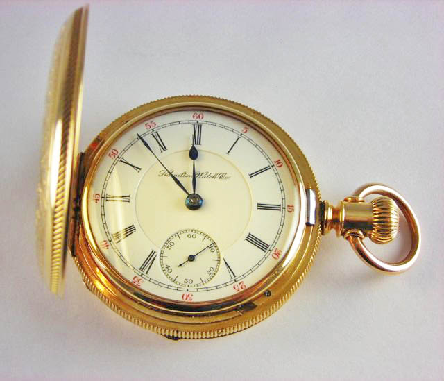

Edward L. Parsons, Jr.While we're on Hamilton track dials, here is an even older 18-size version that had red 5-minute markers, which is my favorite pre-1900 Hamilton railroad-style dial.
It came with Arabic numerals as here on my 938 (movement #13782, circa 1896)
