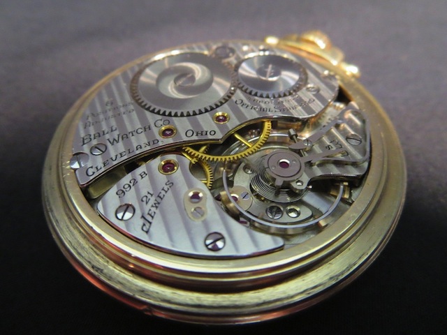

RARE++ HAMILTON BALL 16 SIZE 21 JEWEL 992B 3 STAR RAILROAD POCKET WATCH 24H DIALI would like to say as Ed Parsons used to that I will post the answers on Saturday but I don't have all the answers.
I do however have questions, doubts and suspicions.
Page 153 of the 2015 Price Guide shows a 21J, M#992B, NI, marked 992B & Off. RR Stan., Adj. 6P….★★★ ABP $1500
20 bids to $511 with just under 5 days to closing.
What do you think?

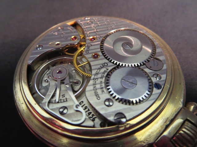

March 03, 2015, 21:00
Lorne WasylishenAnother View
[Movement number: C197456]

Roger StephensLorne,looking at the stripes(damaskeen) appears not to line up to me.I would certainly wnt more input from the guys here that are in the know.

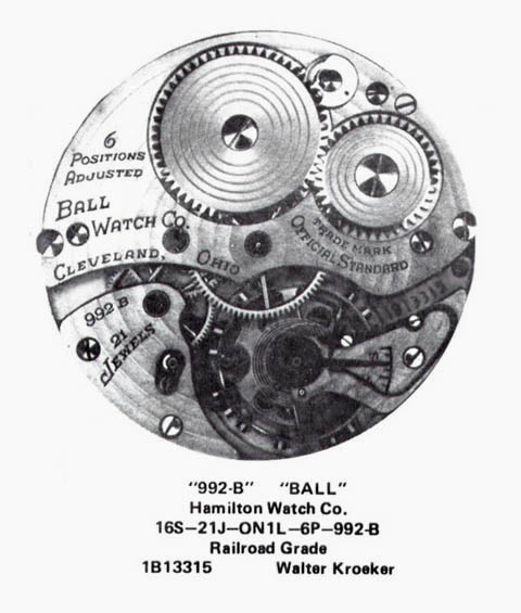

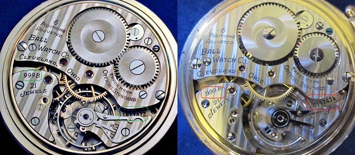

Richard Romero posted the following text and image…
Correct example # 1B27472 on the left and incorrect example from ebay auction [C197456] on the right.

Buster BeckThere were actually never any Ball Hamilton 992B's made from the factory for the market.
There is a report that some 40 years ago a Ball Hamilton 992B #1B13315 surfaced with Ball's standard "round or circular damaskeened" pattern. It hasn't been seen since and its the only one that may have existed and no one anywhere confesses to owning it. Even if it did exist, it was a piece that someone assembled at the Hamilton factory OR was an error that was made up, in any event, it is doubtful that it ever reached the public if indeed one existed at all. I believe all the evidence that we have of that one is in an artist's conception/drawing shown here, but it could be an old Black & White picture, but never the less none of them were ever marketed by Ball or Hamilton for retail consumption.
"C197456" IS a Frankenberry watch with Hamilton 992B plates AND Ball 999B plates that someone has joined to appear to be something that never was. The dial is a Ball Hamilton 24hour dial and it's in a Canadian "Sturdy" case. It is a hodgepodge of leftover parts that will all interchange.
Interestingly the train/barrel bridge plate is off of a straight line damaskeened Ball 999B of which only 700 pieces were made.
Don't be mislead, confused, or deceived by this controversial "coffee table" Frankenstein piece of deception.

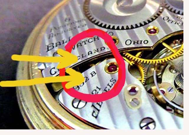

Look closely, the lines on the plates do not line-up...March 05, 2015, 18:02

And think of this, consider the fact that since Roy Ehrhardt shared his image of 1B13315 back in 1980 some 35 years ago and we posted it in public in 2007 at ''Ball Hamilton 999B Models, 21and 23jewel Question - Basic 999B History and More!" no legitimate "Ball 992B" has ever surfaced despite the fact that thousands of collectors have been looking and looking. So...

Picture 1 referred to in the message is the one I prepared and posted several years ago from the "1980 Ehrhardt Price Indicator" showing factory error number 1B13315 that Buster posted above and that first appeared during 2007 in the previous "Ball Hamilton 999B Models, 21and 23jewel Question - Basic 999B History and More!" topic.

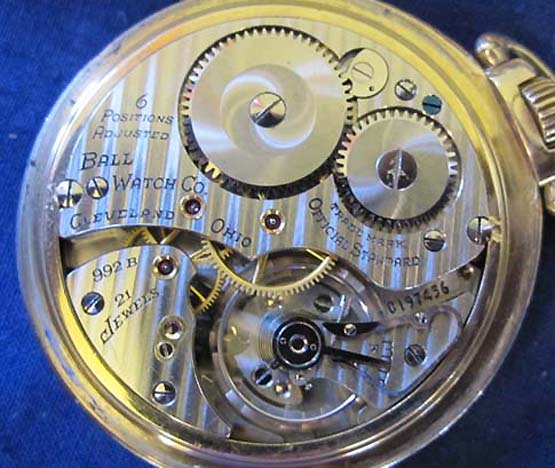

Picture 2 which is attached below is of the fake, counterfeit watch bearing number C197456 and taken from the current eBay auction number 221702053433 to which I added a red circle and 2 yellow arrows in order to help explain what I was trying to point out in my new message to the seller.

Below, my "Picture 2" sent to the seller through eBay earlier today...
