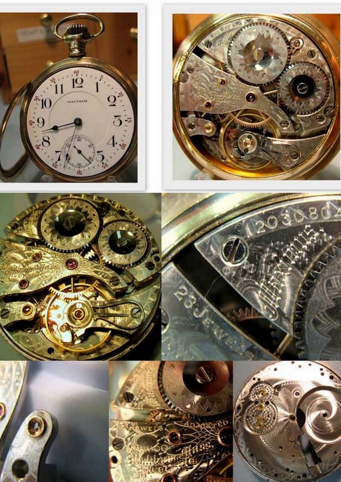

Waltham's Production records show 11534301-500 as the 23 J Maximus. 11534286 is only 15 short of that run, so I have no doubt it is clearly from the listed Maximus 23 Jewel run. There were errors like this in the factory records.
I think this has Diamond caps on BOTH the Escape Wheel and Balance wheel.

Thanks Dave I tend to agree this watch is just to pristine to be a frankenwatch. When I get time I will pull balance in case anyone asks but for now I need to get stuff listed this flu has had me down.

Interestingly I found some photos of a 23J Riverside Maximus hunter also in the same serial # range as yours, 11534249, from an EBay sale about 2 years ago. So at least for your serial # range the database is wrong.

Rob this is one that passed through my collection and is quite like yours. Note it DOES have the same 2 Pair Diamond End stones. Quite a watch!

David: Is the dial on the watch you show correct? I thought all the 16s Riverside Maximus dials had Waltham written in script.

I agree Jerry but not always easy to find here is one on the one I posted

Jerry, sadly the scripted dial was one the watch but had a small corner missing on the inner chapter above the 5 so I replaced it (like a dummy!). The scripted one is probably still here in my dial "stash".
