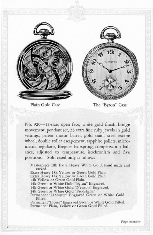

Christopher,
The below Hamilton catalog pages shows the appropriate cases for your 920 movement.

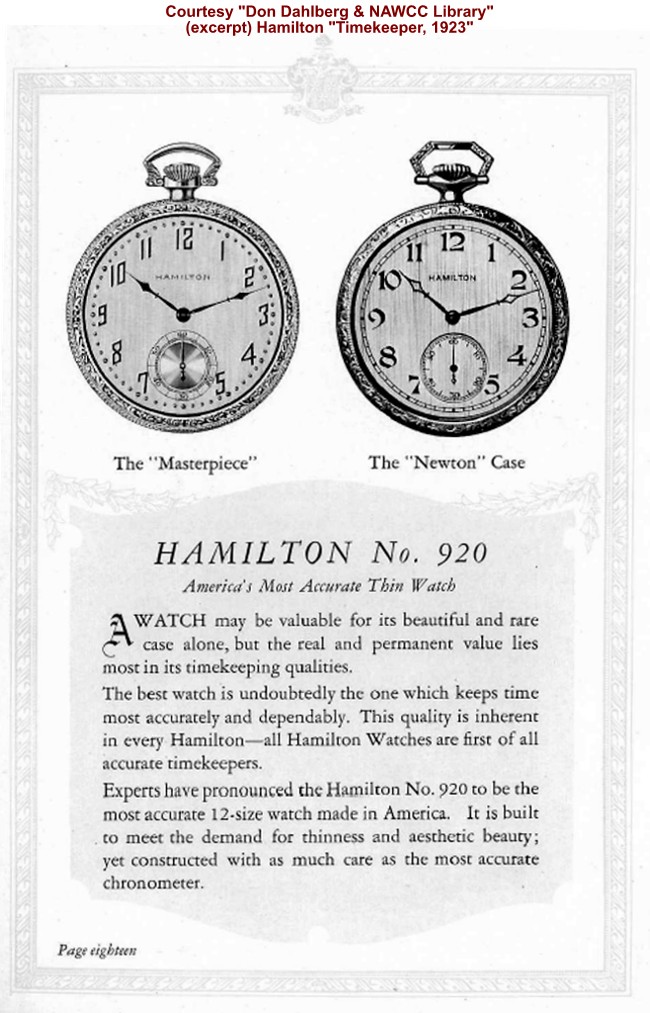

another page......
