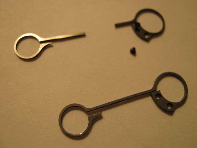

Replacement part and bad guy part

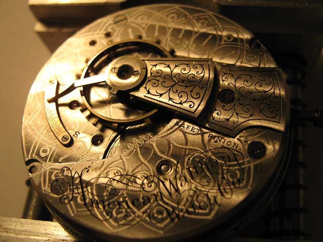

Replacement part nestled in its new home

View via the barrel (mainspring) opening

It is a miracle - it runs...
