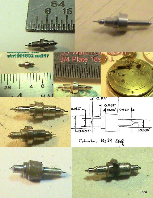

Harry, Sadly many Balance staff designs were modified by the manufacturers over time to the chagrin of watch service people from the beginning to this very day. Generally you can say with some confidence that the same balance staff could be used on similar period movements of the same exact type as with the 974 and 975, but then you have the issue of the pivot sizes.
Making generalizations about balance staffs is ill advised. I have to apply my "machinist's eye" to each and every staff I replace and carefully measure all of the relevant diameters, check the lengths, jewel fitments, make any adjustments possible and necessary, and then pray it works. Fortunately, if I cannot find the right staff in my own generous inventory, I can contact Brian Cavanaugh who has been able (with a proper picture and description) to supply one about 90% of the time . . . including the variants of Hamilton staffs, some of which are in the below collection of our communications of a few months past.

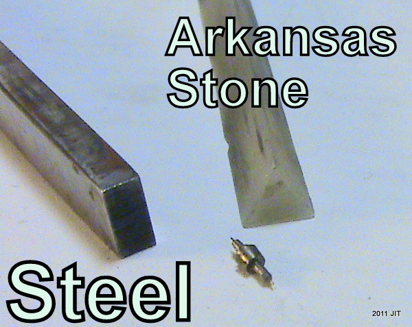

Harry, remove the broken staff from the interesting 975 you have and send a picture of it to Brian so that he can best identify which of the SR variants it is. I have little doubt that Brian will "err" on what he finds for you. Just be ready to polish the pivots (if need be) to fit the jewels.
I generally use a "steel" for the "near" fitment ones and a fine tiny triangular arkansas stone and then steel to gently reduce oversize ones followed by a "rouge polish" after they pass fitment.

November 05, 2011, 16:39
This is what I use;

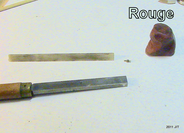

and Rouge . . .

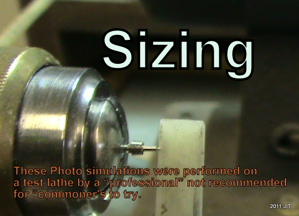

November 05, 2011, 16:40
If it is oversize, I GENTLY touch it up with the Arkansas Stone . . . .

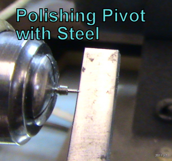

November 05, 2011, 16:42
and I always polish it with my "steel", using the sharp edge and the radiused edge . . .

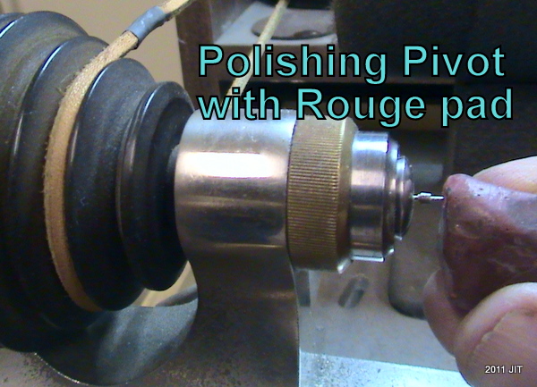

Then I give it a light "kiss" with Rouge . . .

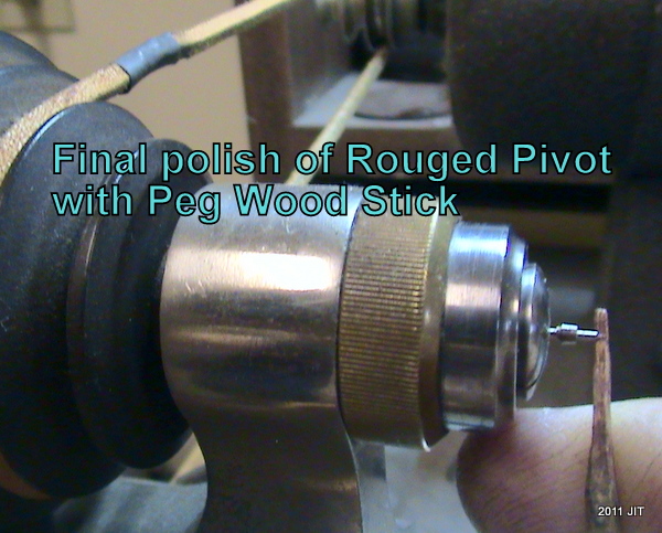

November 05, 2011, 16:43
and finish the job with a pegwood "shiner".
NOTE: These pictures are representational only, the staff is not all the way into the lathe collet, and I did not actually perform the tasks, only took pictures of what it looks like. dca)
