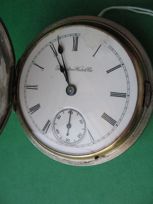

I have this nice old Hamilton 941 that is in a Silveroid case. The problem is the bezel is gold toned. Any way to plate that with no big expense?

Bezel can be nickel plated by any good jewelers' service shop. If this were my watch I would hold out for a good gold filled hunting case with a commonplace 17 jewel Hamilton movement (so as to not have extra case screw marks) and also look for a good double sunk dial. The watch is worth it.

I would have Don Mathis plate your bezel in nickel...
CLICK FOR: Casemaker and Master Engraver Donald Mathis
Don does plating as well as very artistic and proper case engraving.
Now to what Bill said about your dial, all the Hamilton advertising shows the Open-Face 940 and Hunter-Cased 941 as leaving the factory with Double-Sunk Dials. Your movement which is from 1904 production would be expected to front a "Hamilton" in Script Signature Double-Sunk Porcelain-Enamel Dial. And by the way, all the 18-size Hamilton dials interchange between Open-Face and Hunter-Case movements.

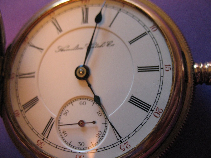

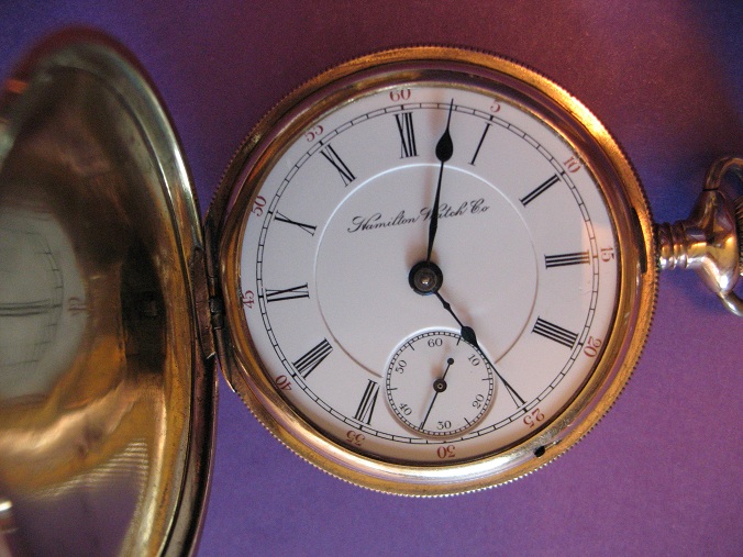

I took your advice and found this case and dial on a 927.
July 25, 2011, 20:22
Mike Hodge
But, the cover wont close with the bezel on. That should be no problem as I believe I can get that replaced with a proper fitting bezel. Now this is a much nicer 941 than before. AND, the screw marks are matched!

Could be the glass is too tall. Pop it out and see if it will close. Some have to use an absolutely flat glass to close.
Try flat polishing the bottom of the bezel [if it's not the glass] on fine emory paper and perhaps enough can be taken off for it to close. But you can take off too much, that's the bad part Frown

Mike, is the problem that the cover does not "lock" down, or that it simply will not easily swing down to the closed position?
I ask because in your picture the hasp that is supposed to lock the cover looks like it is not extending out far enough to work.
July 26, 2011, 11:28
Mike Hodge
Dave, With the bezel off, the case functions fine. With the bezel on, it does not. The SN on the bezel do not match up with the case either. The other parts, lever slot, opening and hinge, all match up fine. Given that, the emory cloth may be my first attempt to solve.
