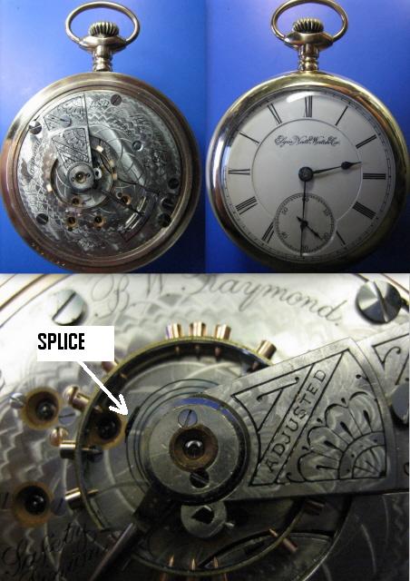

Hello David, Here is another kind of repair you probably haven't seen before. This Elgin came to me with a broken staff and a badly mangled hairspring. I couldn't straighten out the hairspring and finding a replacement was quite a hopless task, so I had to improvise with what I had at hand. As you see from the picture, I had to splice a lenght of hairspring to the one I had in order to achieve the proper vibration frequency. The watch has ben working with acceptable performance for quite a long time now.
I didn't do this in order to fool some buyer because the watch is part of my collection and all watches of my collection must be in working condition...one day somebody will wonder....
Personally I admire people who can get things working again with improvised means, as long the "thing" is not permanently damaged and can be put back in the original configuration once the proper parts become available.

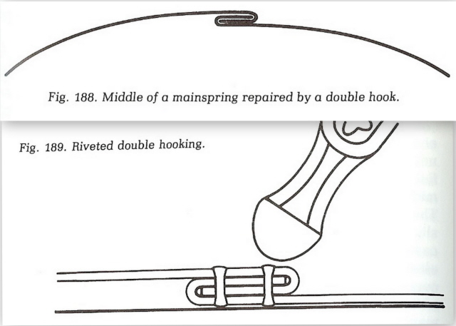

I actually read in a repair manual once that broken mainsprings could be repaired temporarily by heating the broken ends and bending them in opposite directions and hooking them back together. I have even seen watches with this done. seems that the temporary repair turned out to be the permanent repair.

Hello Cecil, Yes, the repair method you described is an acceptable one, but generally applicable to bigger clock mainsprings (as can be seen from the image below).
