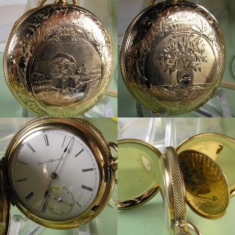

I recently purchased this very nice 8 size Illinois Hunter, my first hunter by the way, And I had some questions about it I was hoping this group collectively could answer. It is serial number 109606 from a poduction date of between 1881-1883. It is a model 151 with 7 jewels. It has a beautiful gold filled case with no manufacturers name other than the gold filled marking in the photo. Everything works perfectly and shows very little sign of any wear. Same is true for the near perfect looking movement which is about 125 years old.

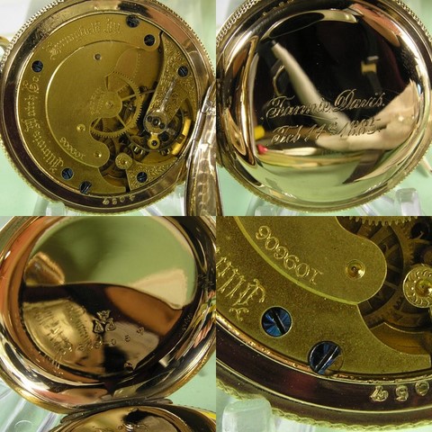

My first question is, could this be a correct case for this time period? It has no other case screw marks in it and it does have the inscription "Frannie Davis Feb 14th 1885". This may have been a Valentines gift (if the holiday even existed yet) or engraved about a month ago to give it some authenticity for the sale. The case seems to perfect to be this old. Any one have something similar for this time period or know something about this hunter case?
Next the movement looks to be in near perfect condition as well except for some id*ot taking and grinding off the edge of the case screws (I still do not see the logic in doing that). The watch runs but extremely fast, several hours per day, and I suspect just a cleaning would resolve that. Any comments on that. I would like to get it into Chris's hands but was wondering if it would be worth it. Also, I would like to locate a couple of those blue case screws if anyone has any.
So let the discussion begin, I would like all criticism good or bad.

Here is another picture of the movement....

Nice looking watch, the case screws are normal, I don't like those type but they are common on a lot of watches, I guess the reasoning behind them was you didn't have to remove them to remove the watch from the case. There are other posts where they have been talked about before.

Hopefully just dirt and hairspring stuck together, I can see its out of alignment, have a good look around the stud to see if anyone has had the stud pin out, possible indication of broken hairspring and end put in for eBay special or any shadows on the balance arms where screws once was, with power off does it look in beat...
