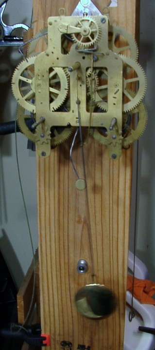

The movement was not in much better condition than the case. There was a short tooth on the escape wheel. A replacement could not be found, so the tooth was stretched as much as safely possible. The wheel was then put on the lathe and put to round. The pallet faces were worn, and with the change in size of the escape wheel, the depthing had to be adjusted.
Four lantern pinions has to be rebuilt. A tricky addition was one of the lantern pinion wires extended beyond the cap and turned the count wheel. A bit too long and it would hit the plate, too short and it would miss the countwheel.
There was a great deal of rust on the steel parts. A visit to Ralph's shop and some time with the microsandblaster took care of that.
Bushings, of course. One element that caused a bit of trouble, was the springs used on the strike train to hold down the lifting and locking wires. They were interferring with the going train. I relplaced the wires and things were fine.
The lifting and locking wires were bent into shaped that guaranteed that this thing would never strike. Getting them back in shape was a fun puzzle.
There were several interesting/unusual about this movement. One was the near lack of end shake on a couple of the arbors. I thought this may have been the cause of initial problems, but it turned out to be the pesky wire springs on the strike train.
Pictures of the movement before work was done are hiding somewhere. I am seeking them out. I will post a picture of the completed movement soon.
August 29, 2004, 19:40
Tom Seymour
Here is Brighton's movement. Running and striking well and keeping good time.
