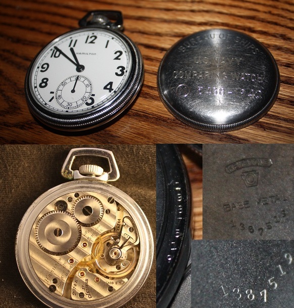

I just received this watch last week and was some what surprised/disappointed in the relation of the engraving on the back to the crown location.
The seller's picture of the back was of just the back, not screwed on to the body. The case numbers do not match, which I understand is not that uncommon with these military watches.
Any thoughts on the 90 degree difference of the engraving compared with other military watches.
Was it just a screw up by the engraver?

It is possible that the screw threads may have been worn or damaged and recut so that the back does not screw down in the same final orientation that it did originally. Another possibility is that the back may not be the original one to the watch. It could be a replacement for a damaged one or it could also be 'not right' and added to add value to the watch. There are a number of operations in Eastern Europe and Southeast Asia these days where military engravings are being added to ordinary cases and dials to increase their value now that military timepieces are becoming more desireable and expensive. Your back engraving looks reasonable, but it does not quite match the back engraving shown on the 2974b photograph in the Marvin Whitney book on page 233. The serial number line formatting is not the same. It may be okay, or it may not. I just get uncomfortable and want to do more research when something does not quite match.

Richard Romero
Ed,
I think the case back is properly engraved. It matches the case back on my 2974B and is within 300 serial numbers. All four case part serial numbers match on the example in my collection. The writing on the back lines up when it is screwed down.
The case back must have been switched at some point. Another alternative is the case frame was switched. You should be able to tell by comparing the dust cover, bezel, back, and frame numbers.

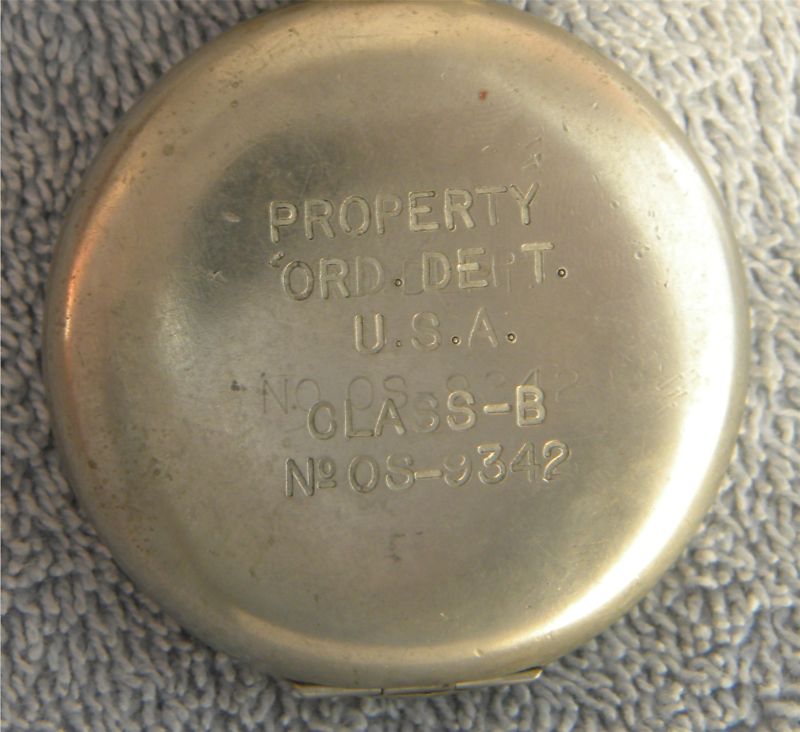

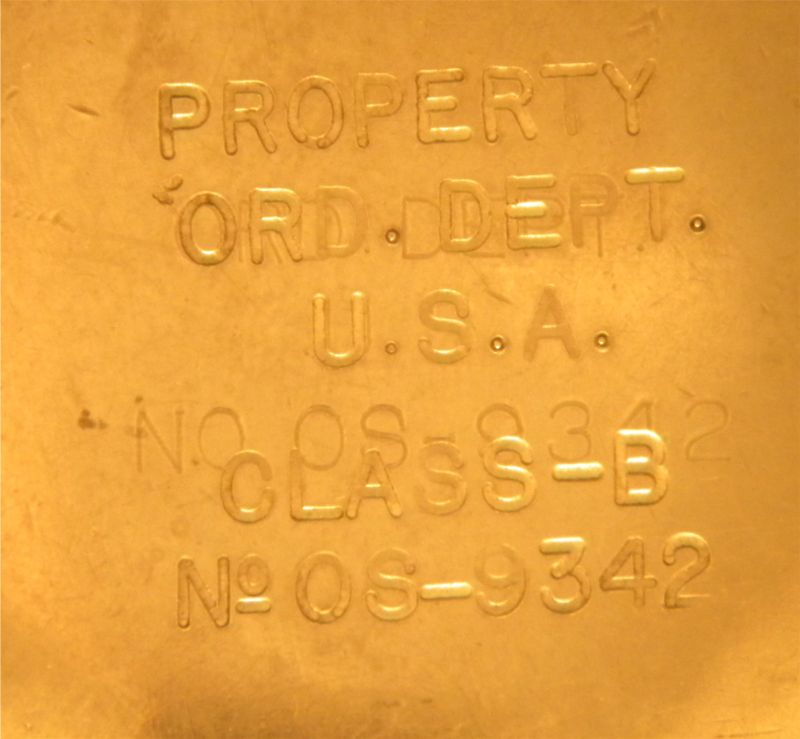

I have a Hamilton Model 23 with the same issue. The rear case lid is orientated slightly counter-clockwize to the 10 position when fully screwed. The case numbers do not match and like you stated that happens quite frequently with military pieces during repair. Unfortunatly I can not produce a photo right now as it is off being serviced. What I can produce right now is another slightly related issue. I just got in an Elgin 60sec timer. The ordnance nominclature on the rear case seems to have been stamped twice with the same information. Might this be the same possible European and Southeast Asian work? I will post some pics if I can. Thanks.
December 31, 2010, 14:51
Michael Payant
Another view of markings

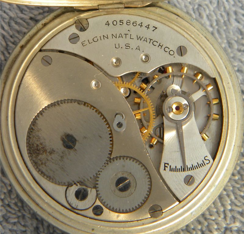

December 31, 2010, 14:53
Michael Payant
Another shot of serial number of movement. Maybe early Elgin timers such as this were stamped twice for some reason.
December 31, 2010, 16:16
Edward Kitner
Richard, I believe the back was switched for what ever reason. All the numbers match except the back mumber.
Thank you all for your input. At least now I know the back is origional to "a" USN comparing watch.

Jim Hester
