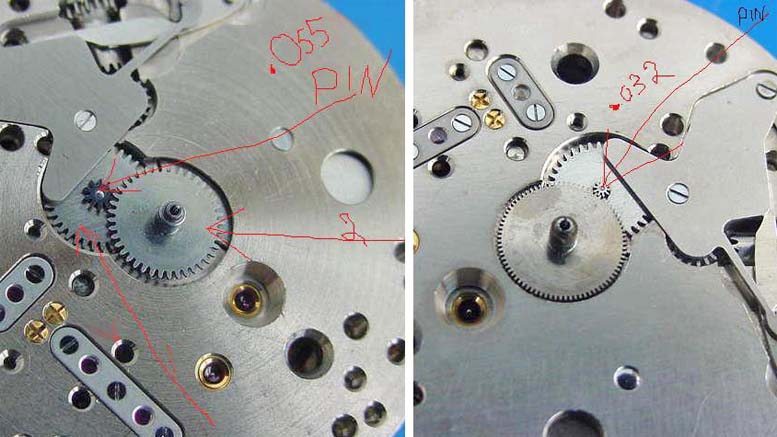

So here is what has to be changed.. The minute wheel, the hour wheel, and minute wheel arbor which takes more tear down than just removing the dial.. The 4992B on the left is a 12 hour watch and the one on the right a 24 hour watch...First thing you will notice is the minute wheels marked #1 are different the outside dia. and the tooth count on the wheels are the same but the little gear in the 24 hour watch is much smaller and more teeth than the 12 hour watch. You will also see that the hour wheel #2 on the 24 hour watch has 2 times as many teeth as the 12 hour watch..Also the pin or arbor that for the minute wheel is much smaller. The 12 hour watch has a pin .055mm and the 24 hour watch has a pin that is .032mm..
You will have to remove the set bridge it is held in place via. 2 screws in order to remove the minute wheel.. After you remove the set bridge you will need to remove the set spring winding pinion, set gears, etc.. They will fall out once you turn the movement over so its better to go ahead and remove them or you will be crawling around on the floor trying to find them.
Next the pin or arbor #3 has to be changed in order to get the pin out you will need to get at the back side of the pillar plate in order to press it out.

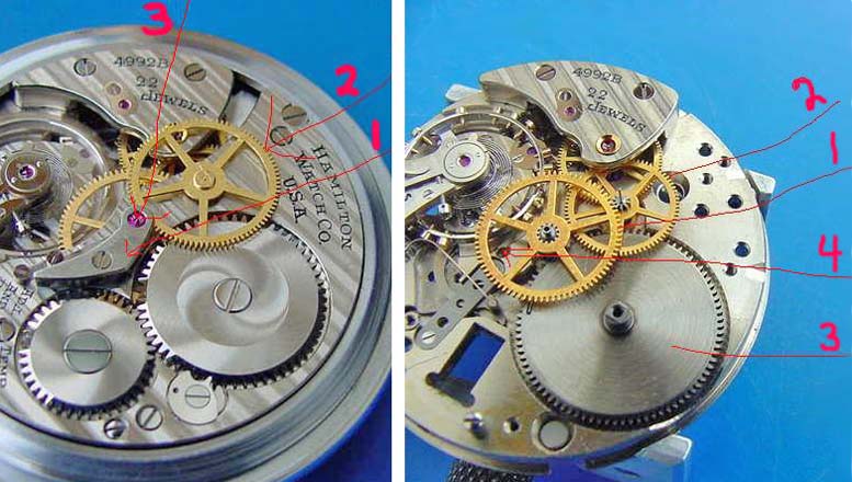

PICTURE ON THE LEFT BELOW:
After you have removed the parts on the dial side you will need to remove the #1 sweep second bridge, #2 the sweep second wheel and # 3 the sweep second pinion.. At this point you will also have to remove the mainspring barrel cover..
PICTURE ON THE RIGHT BELOW:
Once you have the mainspring bridge off you will need to remove #1 the center wheel, #2
the 3rd wheel and#3 the mainspring barrel.. The pin # 4 sets very close to the balance so I go ahead and remove the balance cock and balance wheel as an assembly. Once you have all the parts removed you can knock or press out the pin for the minute wheel.. These have a slight taper so they come out fairly easy...

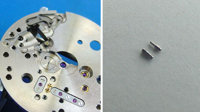

Samie L. SmithIn this last set of pictures, on the left I have already removed the large pin and replaced it with the smaller one and then the watch is ready too reassemble..
The picture on the right shows the pins on the left the 12 hour and on the right the 24 hour one.. They have a slight taper and the same size where the fit in the plate..
I hope from this you can get a better idea of what has to be done..

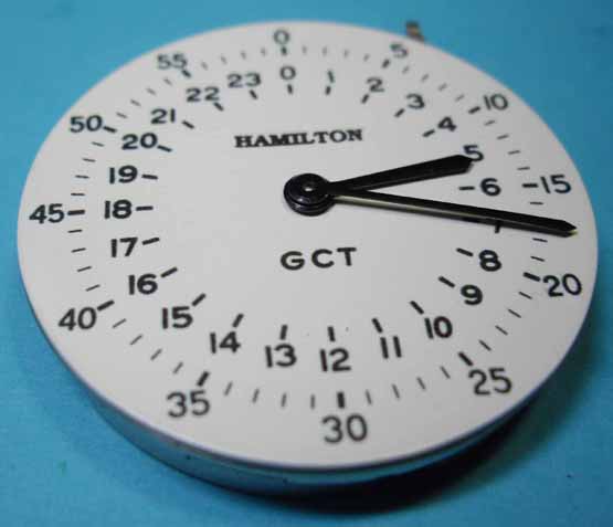

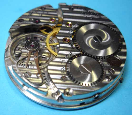

John ScottI have just benefited from this valuable information, plus the kind and efficient assistance of Larry Crutsinger, by being enabled to play another but related game that I have had in mind for quite some time.
I have concocted a Hamilton 992B watch that shows 24 hour time. I have been wanting a watch adapted for traveling but I do not like pendant setting watches.
To create this watch, I did not destroy any existing watch as I obtained all necessary parts via the internet. The resulting watch is a Hamilton having a pillar plate numbered C183867, which I bought as a bare item.
The photographs give the idea. It is to the great credit of the Hamilton watch company that everything fitted together, perfectly.
The absence of a second hand will be noted but my timing machine assures me that such a complication will not be needed. I will not be frustrated by to-the-second timing and if the watch should gain half a minute, or so, in a month's traveling, I won't be missing any planes.
I don't suppose there would be many such watches in existence!
John Scott
October 20, 2013, 02:03
John ScottThe dial.

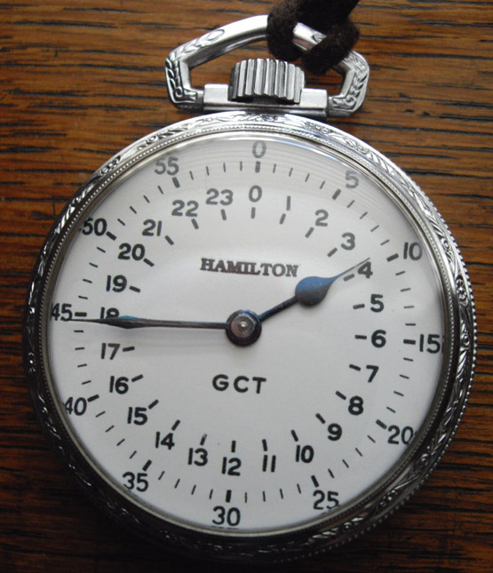

October 26, 2013, 00:05
John ScottAfter carrying the watch for a week it has settled down to the exemplary performance that can be expected from a really good 992B. Much as I like the baton hands, I had to accept that they were too long. This is the watch as it now is.
