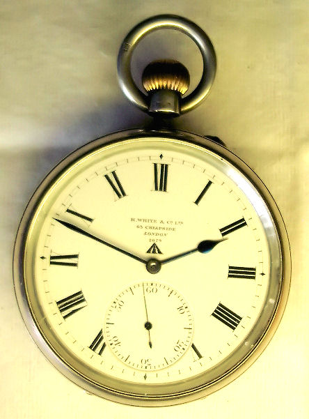

Hi All,
Another one of my Military Pocket Watches for your perusal, any comments welcome.
The Dial and movement are signed H. White & Co Ltd, 65, Cheapside, London. Both the dial and movements also have the 'broad arrow', but no other markings at all.
The case body, covers, movement and dial all have the same serial number '2079'

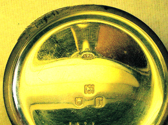

The 'open face' case is assay marked for London 1912, but with no silver 'grade' mark. It appears totally unused with no wear to speak of anywhere, not even on the gold plated crown, which is spotless even in the flutes!
The casemaker's marks 'ATO' would be: Albert Thoms Oliver. 31, Wynyatt St, Clerkenwell, London. (Mark Reg'd 1903)

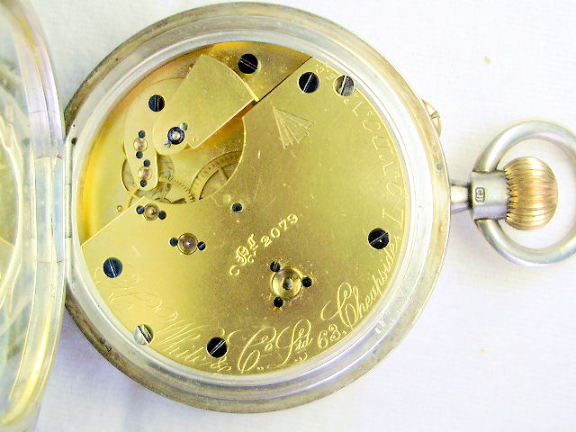

The 'Stem wind / Pin set' movement is likewise virtually untouched and high quality, right down to it's screwed in jewels and diamond endstone.
It is missing its balance and lever (club toothed escape wheel) and appears it may never have had them fitted, all the beautifully 'Blued' screws etc are absolutely pristine and look completely untouched.
Even the back cock looks completely untouched with no sign of a hairspring stud ever having been fitted (or removed!).
There is also no provision for an index lever, so assume it would have been calibrated purely by hairspring positioning.
Could this have been an unused / un-issued Army watch? Anyone come across anything similar?
Pic's posted below.
Best regards
John Woolsey

John WoolseyH. White & Co Ltd. Movement!

John WoolseyH. White & Co Ltd, Case Hallmarks.

Greg CrockettA rather nice watch.  I would guess it was intended as a comparing watch for the Royal Navy, but then something happend about the time it was delivered.  I would guess the lever and balance may have been removed and sent to another watchmaker for re-staffing, only to be lost. Thus, the fine watch went into a drawer never  fixed and never used.
One wonders if it might not be possible to locate a similar movement and rework the fork and balance to fit this fine watch?

Jim HesterThis is a really beautiful example of a fine early military watch.  I think that Greg's thought seems to be the most likely story.  The only other possibility I can think of could be that the government's order was ended or changed in favor of the more modern watch specification one sees in the WW I era watches and this pristine example may have been an unfinished and undelivered watch left in the maker's stock.
Hopefully you will be able to find the needful parts to put her in full working order, though given that no one has done this yet for the past 95 years I would be a bit worried that the parts  may not be easily found and may need to be hand made by a talented watchmaker.

I need to establish what sort of escapement may have been intended for the watch at the moment.
I have loads of spare movements for Swiss and English lever watches, which span two centuries of watchmaking, but I've never seen one with a balance cock like this one.
It was clearly never intended to have an index, as all the engraving had been done and there's nowhere to mount a lever.
I've a gut feeling it may have been designed for a balance with a helical hairspring, if so, that will be a tough one to get around.
The gap between the pillar plate and the underside of the balance cock is also unusually large even by English lever standards.
I recon the pallets and lever will be a 2x piece job, as the pallet arm needs to be aligned with the axis of the lever, and adjustable.
I'd like to kit it up with a type of balance and lever which would have been used originally, but may have to settle for some other arrangement in the end.
I have several suitable high grade balances I can use, just need to ensure I use one that's appropriate to the movement (split / Solid etc). Setting the timing screws in the right place will also be fun!
I'm pretty sure White will have been the maker, but will investigate that further. The company was certainly operating close to the casemaker's premises.
I do think that the watch was never issued though, which would fit your theory Jim.
I've taken another look at the balance cock etc, and the gilding is as bright and crisp as the day it was done, it's perfect and unblemished.
There's not the slightest mark anywhere near where the hairspring stud would have gone or anywhere else.
Even with the best will and watchmaker in the world, it would take a superhuman effort not to make a single mark on the gilding whilst removing a taper stud / pin to get the hairspring off. I really don't think one was ever fitted.
Even the screws are perfect, I'm quite reluctant to put a screwdiver near them they're so good!
I almost feel I'd be defiling it by fitting it up with a balance etc, but it would be better working than as a dead museum exhibit for sure.
I just need to get it 'Right'!

Frank J. MenezAssay Mark Lion Passant 92.5
March 09, 2006, 17:20
John WoolseyMany thanks Frank, must have had my brain out of gear not picking that one up!

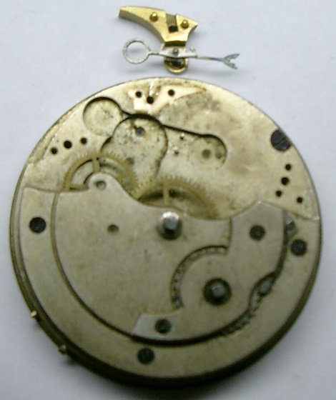

One type is a 'Swiss' (?) lever pocket watch movement made by Kendal & Dent, who were makers of fine movements, the other a Longines PW. The Dent, is a 'parts' movement which is strikingly similar to the Longines, but unfortunately has no escape wheel, or balance. The lever is all steel, with detached steel pallets. I would not be surprised if it were in fact a Longines, as K&D were notably good makers and would have used correspondingly good movements if 'bought in'.
The Longines is also a Swiss lever PW movement, and has steel 'one piece' pallets attached to the lever as with the 'Kendal & Dent', and the balance has a single roller table with a ruby jewel
Levers on both movements are counterbalanced and have an upright locking pin above the fork, so I've now a better idea what needs to be manufactured.

John WoolseyKendal & Dent lever 'Donor'
Apologies for the quality (or lack of) of the photo.
The lever is shown 'upside down' pallets upwards.
JW.

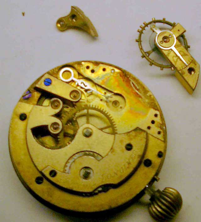

John WoolseyLongines 'fixer upper/' escapement

Greg CrockettThe balance of the Longines (Longines marked) indicates that it was not one of their high end watches, but a watch of average quality.  Thus, not suitable as parts for your high end admiralty watch.
Doing the work yourself is a viable option, if you have the time and the skill. As you are aware, anyone working on a historic watch like this should follow the basic rule that whatever you add to the watch can be taken off without any changes being made to the original movement.
The price quoted seems rather high to me, but then I tend to be rather conservative with valuations (and I'm cheap).  For true value, consider that even after all the expensive time consuming work is done, it will never be 100% original.
Given the time it would take a hobby watchmaker like me to make this watch work, I would seriously consider selling or trading the watch away. But then, that's me, all of our situations differ.
Thanks for the update.  What ever you might do with the watch, I hope you will keep us informed of the steps in the process.

The Longines and parts watches won't be used to finish it, but they do give me patterns to work around now, as I'd no solid idea of how the lever and pallets of that type would have been constructed in that era.
I need to research which type pallets would likely have been used in the conversion though - steel or jewels, it will affect the construction of the lever itself, and it needs to be 'Right'.
Looking at the watch plate, there is an area milled out next to the escape wheel, which suggests the actual pallets are below the lever, so would probably have been a one piece steel job like the Longines.
Reversability of any work won't be a problem, as it's a philosophy I apply anyway to all repairs I do. All the work that's needed though is to add stuff that's missing rather than change anything.
I can't comment either way on the quality of the Longines as I've nothing to compare it with. It seems to be an early model, as it appears to predate jewelled pallets and overcoil hairsprings which I believe later models have, also has a basic roller table and upright locking finger, not at all like later Swiss levers.

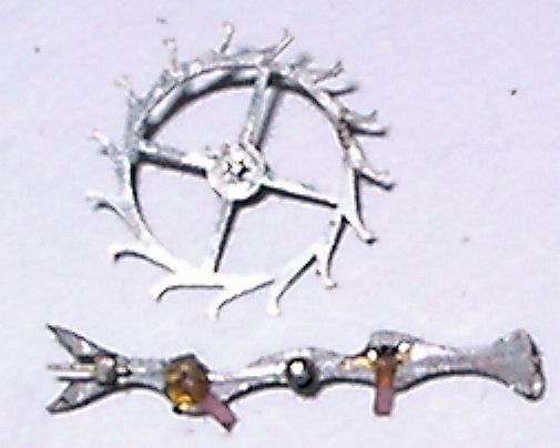

I'm going to go with steel pallets on the watch when I get started on it, I feel pretty certain now it's what would have been fitted.
I've managed to turn up a Swiss lever watch with jewelled pallets rather than steel, and they're mounted in the side of the lever, not under it which is how my watch would have to be.
All levers I've found so far with the pallets below the lever are steel.
I've posted shots of an English lever of the type, and the jewelled Swiss lever version below.
Best regards
John
1st shot is the English lever & Escape Wheel, 2nd is the Swiss jewelled equivalent (first I've seen).

John WoolseyThanks for the input Stephan,
The types of lever you mention, do have 'slips' of Ruby inserted into slots which are milled into the pallet faces too.
It's not clear in my English Lever example shown above (photo 1), but this one is actually equipped with the type of jewelling you describe too (unfortunately I've been unable to edit my older postings to correct the description).
I'll try to insert photo's of both types in my other topic.
Some levers of this type though, just have polished faces, so the jewelled type is a further refinement.
I'm fairly sure my watch would have been kitted out with pallets similar to those shown in photo 1, simply based on seeing good quality examples of 'Regulated' English Lever movements.
