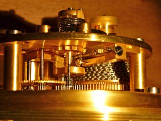

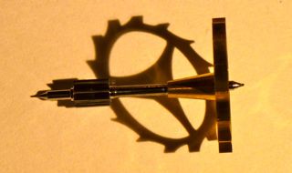

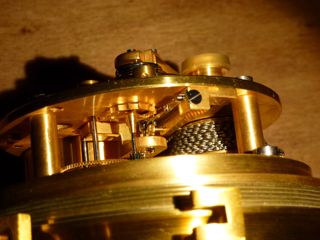

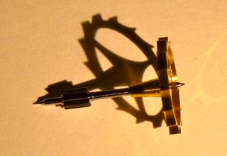

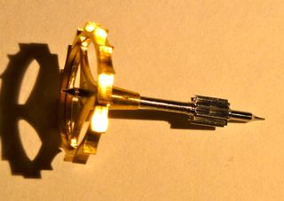

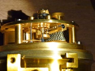

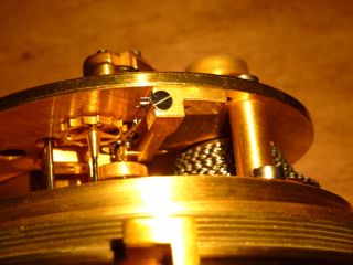

Could you post pictures of this clock and the broken escape wheel? Did the pivot break on the same side in both cases? Do you have both broken escape wheels?
June 01, 2011, 14:29
Paolo Gramigna
Hi Roger,
both the escape wheel had a broken staff pin, the one nearest to the wheel. One is still inside. i'm sending a few photos to you.I have both the wheels (one in, one out)
/Volumes/MacDisk Observatory/Poljot rotto/escapement wheel small.jpg
/Volumes/MacDisk Observatory/Poljot rotto/escapement wheel good side.jpg
/Volumes/MacDisk Observatory/Poljot rotto/escapement wheel 2.jpg
/Volumes/MacDisk Observatory/Poljot rotto/detent.jpg
/Volumes/MacDisk Observatory/Poljot rotto/detent 2.jpg
/Volumes/MacDisk Observatory/Poljot rotto/detent 3.jpg
/Volumes/MacDisk Observatory/Poljot rotto/detent 4.jpg
paolo

Paolo Gramigna
how do you attach multiple photos?
here is another
June 01, 2011, 14:30
Paolo Gramigna
and another
June 01, 2011, 14:31
Paolo Gramigna
another
Paolo Gramigna
one of the detent
June 01, 2011, 14:32
Paolo Gramigna
more detent
Paolo Gramigna
detent 3
June 01, 2011, 14:33
Paolo Gramigna
detent 4

as i told you, i hate to have this chronometer relegated to the paperweight role...
but how can be possible that two escape wheel failed, both on the upper side (the farthest from the driving pinion)?
i definitely will need to locate an EXPERT to work on it...
i know, shipping abroad will be costly and complicated, but i would like to try.
paolo

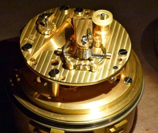

Werner Rosier
by the way this is how it was packed, the damage was caused by an insufficiantly corked balance.
