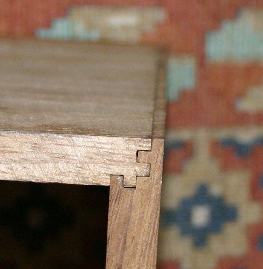

I'm trying to make a wooden box for a marine chronometer. It is unusual in sliding together.
Does anyone know its name?
Has anyone seen an example before?
How was it made in 1860?
Peter

Jim HesterI've always heard this kind of joint referred to as a 'lock joint'. They are supposed to be a bit weaker than a dovetail joint, but it is a fairly fast joint to mill by a machine compared to a dovetail which back then would have been hand cut. The more commonly seen type of machine made joinery for small boxes or drawers is called the box joint which is where the ends of the two pieces of wood to be joined are run across a gang of sawblades that cut many equally spaced and sized square 'fingers' which are simply interfingered and held together with a bit of glue.

The joint is infact remarkably strong, much more so than I would have expected.
One side of each (of 4 pieces) requires 4 operations so there is a lot of lining up and machining to do.

Jim HesterWere I to try to make it myself, I would do each side with two passes though a milling setup. The easiest with modern machinery would be with two different router heads on a router table. It could also be done on a table saw in two passes - the verticle board done with one with a stack of three blades and then with single blade. The horizontal board would be done with a stack of two blades with a spacer for both passess.

If it were a production issue I would make (or assemble) the cutters you describe, however I do not have a router table or a table saw. So i used my 'metal' mill, made a jig to hold the wood pieces correctly, and got by with two cutters, a 3/8" and a 1/8" . I allowed a bit of clearance by taking selective cuts a few thou up and down.
I judged I allowed too much clearance when three sides slid home easily, but the 4th was much more difficult. The joint is 7" long.
