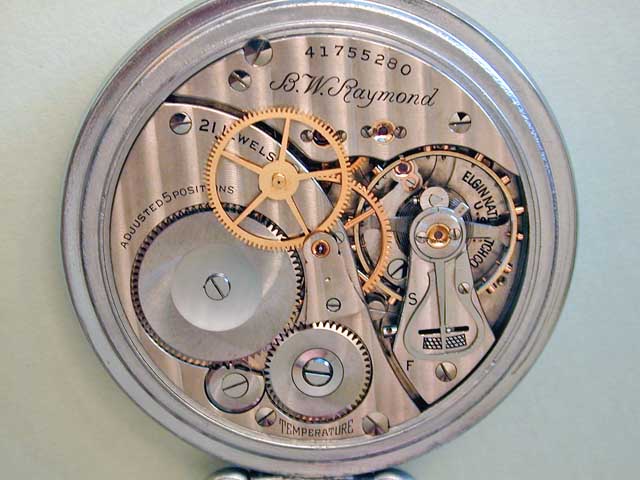

In the image below this post you will see Elgin B.W. Raymond number 41755280 which is from my collection. Click that number to see the Elgin Database search result, also, providing the movement number in questions always helps in research. Smile I agree with Claude's information, the 22nd Jewel was added to a nominally 21-Jewel movement and the 21 versus 22 thing can be a little confusing. Hamilton did a more professional looking re-design on the 4992B which was produced in far greater quantities and for a far greater time period.
The dial is black with white 24-hour markings and "G.C.T" for "Greenwich Civil Time" above center, similar in appearance to and often mistaken for a 4992B at first glance. Apparently the government had Elgin help with production during the 1942-43 shortage of material, same thing happened with Jeeps when Willys-Overland of Toledo could not keep up with demand and some were produced by Ford at their River Rouge facility.
Outside case-back markings on my Elgin are... "AN-5740 (This is the government classification for these watches regardless of manufacturer), MFRS. PART NO.-1790 CONT. NO. W535-AC-37880, SER. NO. AF-43-2919 (A 1943 Army Air Corps. Contract) , ELGIN" and inside "CASED AND TIMED BY ELGIN NATIONAL WATCH CO." in a circular pattern with Keystone Trade-Marks, BASE METAL and case number 95313 beneath.
Hope this helps,
Uncommon Elgin "G. C. T." 22-Jewel movement...

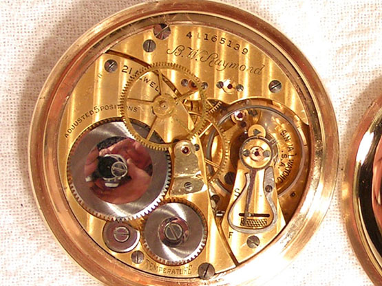

Thanks for the info. I've already checked the Elgin site and it is just as Jerry King stated. I've attached a picture of the movement and the dial.

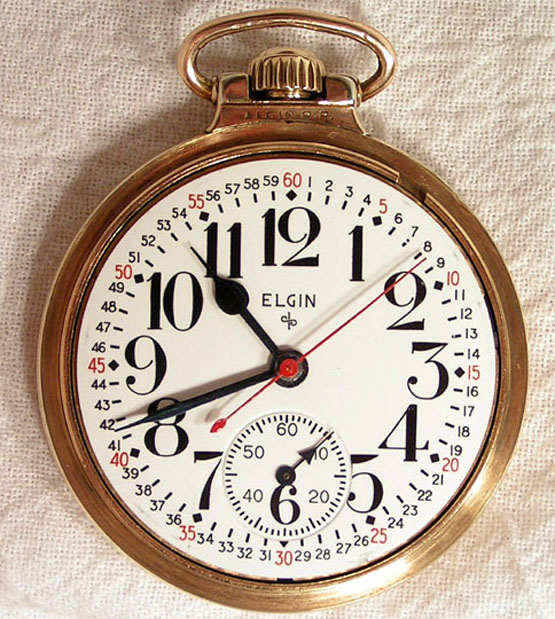

Here is one of the dial that is on the Elgin SCT
