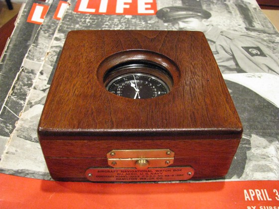

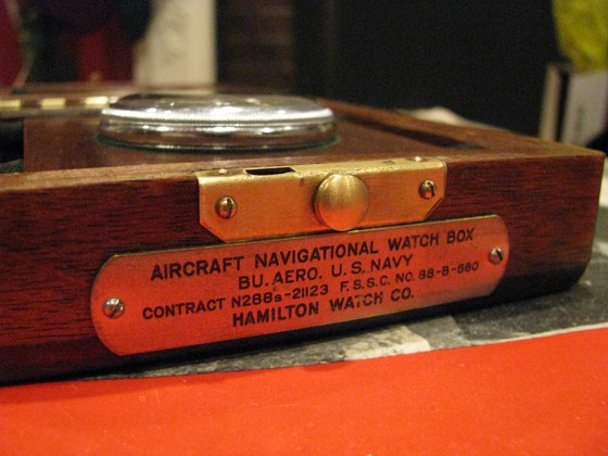

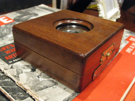

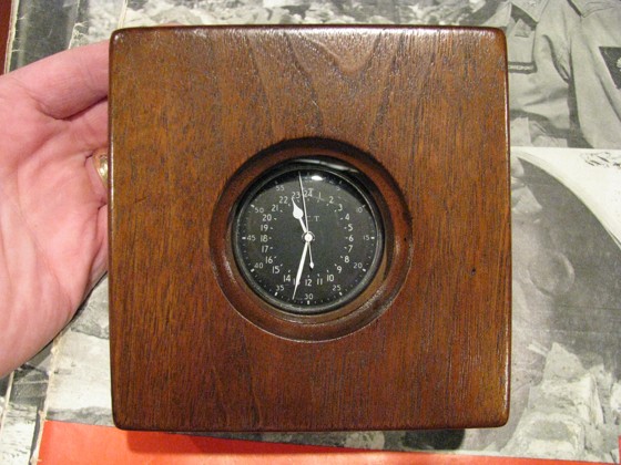

Michael PayantWell I have finally finished the restoration of this case. I am one for keeping things as original as possible but the condition I found this one in was quite unacceptable. The outer shell was very sloppily lacquered over and over again and was covering the glass viewing portal, latches and hinges. The latches did not work properly due to this heavy laquer. Also on the bottom there was black paint under the lacquer as well as four worn down rubber slip discs that were lacquered over to. Inside was not much better. The Neoprene shock absorbers were rotting and giving off a very fowl odor. Several had fell off and were rolling about inside the case. The inner watch holder was in Ok shape and I was able to save the original felt watch liner. The upper and lower wooden “sandwich” pieces were in Ok condition and they were just cleaned with some special wood cleaner/oil. Under the bottom watch holder piece a black tar like substance had dripped along the left side and under, that had to be removed as well.
I used a gentle “Furniture Refinisher” not stripper to remove the several layers of laquer, paint, tar and what ever else was covering this thing. I then had to apply a stain to match the original walnut color inside the case. I then applied a satin laquer to match the original non glossy finish. The neoprene shock absorbers were tricky trying to find the correct material and making the cylinders to match what was original. I ended up getting some thick Neoprene sheets and punching 5/16 circles. I then glued these circles together and made the 16 side shock absorbers as well as the 8 absorbers that are placed under the inner wooden holders. This had seemed to be my best option.
Ladies and Gentlemen, I am one for originality and keeping the history or such an item but if you had seen this prior ( I am sorry for not taking before photos ) you would agree. This was not useful at all and non operational. Plus my little guy (4 yrs old) said it “stinks like poo” and could not have it like that. Please let me know what you think and please let me know if you have any more ideas for the shock absorbers as they are not glued in, they are just held by the resistance they give each other from force. I did this so if I had to remove them it would be quite easy. Thanks all and Happy Holidays!!!!!!!!
