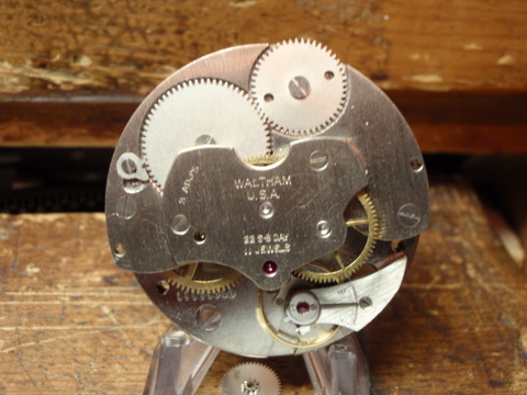

First the movement itself.
movement

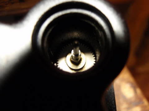

Looking into the rear of the case at the winding shaft
shaft

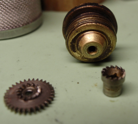

The clutch, winding pinion & cap.
Thanks for any help you might give.
parts

GREETINGS TOM, YOU HAVE A SPRING MISSING, IF I REMEMBER CORRECTLY YOU WIND THE CLOCK IN THE UP POSITION AND SET IT IN THE DOWN POSITION CONSEQUENTLY THE SPRING WOULD SLIP ON SO IT FITS BEHIND THE CLUTCH SHOULDER. I MAY HAVE A SPRING IF I DO YOU CAN HAVE IT. EDDIE

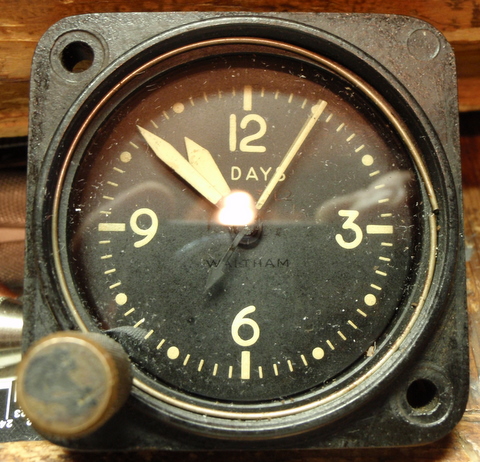

Here is a photo of the clock back together minus the missing spring.
About when were these made, the serial number on the movement doesn't return any info in the Waltham database. The serial number is 33865048 & the movement is marked 22 S-8 Day 11 Jewels

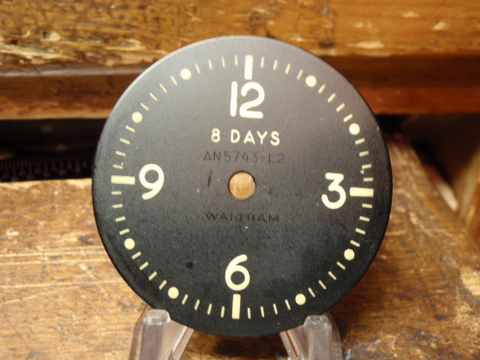

The style of clock is called the A-11. They were produced in the 1940s and early 1950s. Most of them were WW II era make military aircraft panel clocks, but there are post war ones as well. These are all well marked with a military plate on the back. Often they are also well marked with printing in black paint on the black dial. I can see the Waltham name there in the black paint, but the hands are in the way for me to read what is printed above that in black paint.
August 12, 2009, 18:56
Sorry about that Jim, it is marked AN5743-L2. There is no plate on the back.
dial
August 14, 2009, 17:16
Jim Hester
AN5743 is one of the standard set of specs for A-11 instrument panel clocks of the 1940s and 1950s by the major watch/clock makers, including Waltham, Longines, Elgin, etc. While most of these were used on instrument panels, some were also used in other areas of the aircraft.
The L in the appendix number to the AN5743 means it is the variety that was delivered with the extra long winding knob as opposed to the regular shorter winding knob. It is a shame that the military data plate is missing from the back of your case as that would have provided additional information that could have nailed down more information. Howeer, I did a quick look up of the serial number and from what I can see it appears that the movement was made between 1953 and 1954 and so it is likely the clock would have been delivered to the Air Force around 1954 or maybe 1955.

I do need the spring that goes on the back end of the winding stem, I can't wind it with the knob right now without the spring.
Or if someone could post a photo of the missing spring with it's measurements perhaps I could make one.
Thanks again
August 21, 2009, 16:36
Member Mack Davis kindly sent me the missing spring & now the clock is running great, I like the 8-day part to it. I won't have to remember it everyday.
