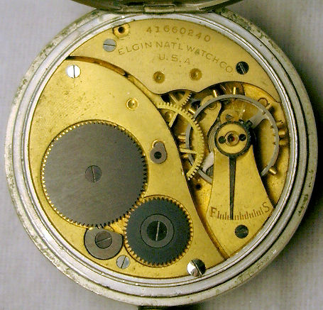

Elgin Timer, Enamel dial. No indication of how many jewels, can't see any on the train except the balance & pallets.
Movement marked "41660240, Elgin Nat'l Watch Co,U.S.A"
Movement plates and bridges appear to be plain machine finished brass, with chemically blackened winding wheels, click and screws.
Mono-metalic balance with timing screws and flat hairspring.

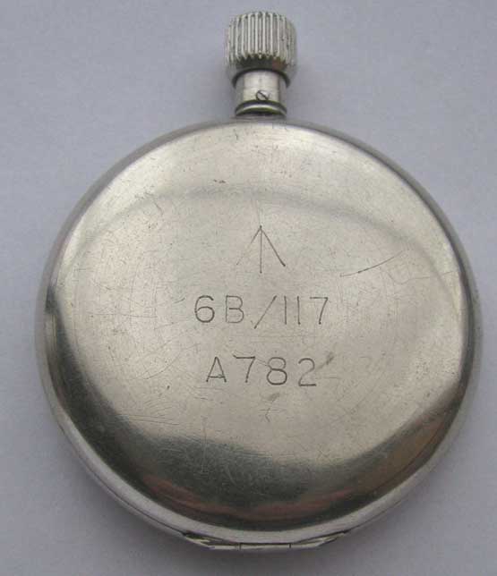

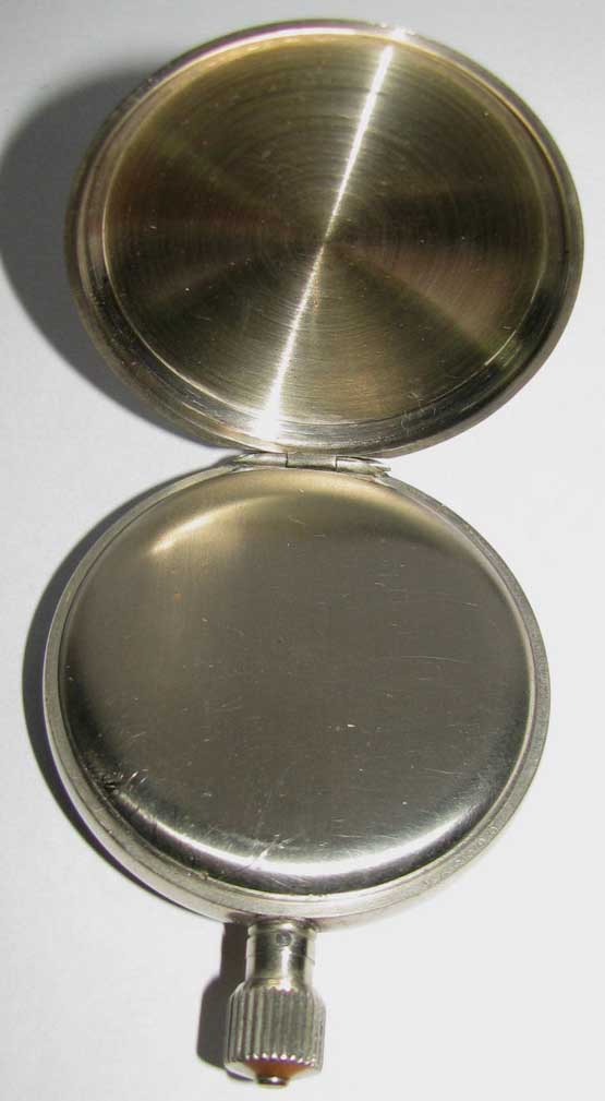

The case is nickel, with a snap-on bezel and hinged inner and back covers.
Case back stamped "6B / 117" under the 'Broad Arrow', with "A782" below.

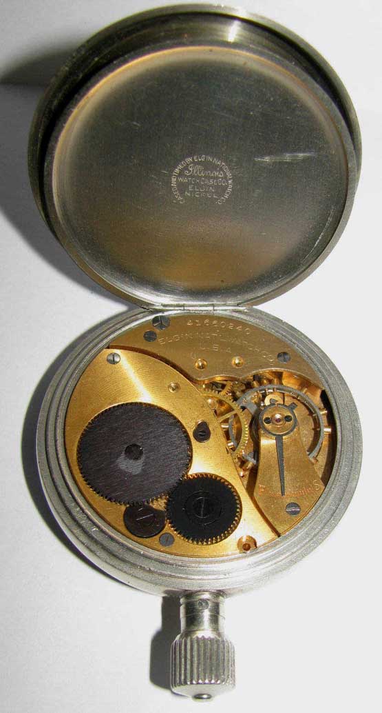

Inner cover stamped "Cased and Timed by Elgin International Watch Co" in a circular fashion with "Illinois Watch Case Co. Elgin. Nickel" inside the circular outer script. (apologies but couldn't get a good image of the stamp).
The Timer winds and runs well, but the 'push to set' mechanism is jammed.
All and any comments appreciated.

John WoolseyElgin Timer Case back

John WoolseyElgin Timer Movement

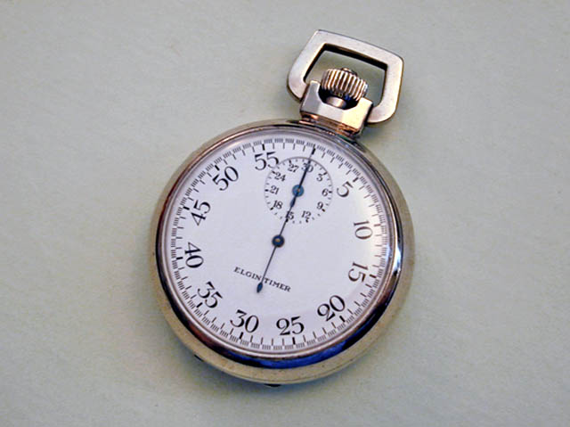

John,
Below you'll see an image of the Elgin Timer serial number 41106730 in my collection. These are really interesting and of very high quality.
February 21, 2006, 17:18
For your information and to help in matching here are the hands close-up.
Hope this is of help.

John WoolseyHi Lindell,
Many thanks for the excellent photo's, they also answered a question I forgot to ask ....'Counterbalanced' hands!
Your watch looks a beauty, I do notice a couple of differences though, your watch has a sunk sub dial, whereas the dial on mine is flat across, also, yours has a bow and boss to mount it, whereas mine has nothing, just the pendant.
I've had a good look under the loup and there's no sign of anywhere to mount either, and no sign of anything ever having been fitted.
Was this usual between model variations do you know?
Also mine has a plastic crystal, was this usual too, or should it be glass?

I've owned at least three of these and have also seen a few loose dials available. Just a guess, but perhaps the flat dial was for a slimmer case or a cost-cutting move. One of the others I had was in a very different style case. They probably came many different ways. Since yours is British issue it may have been cased there too. And if so, that could explain some of the differences.
The one in the pictures is unusually nice and it has what is apparently the original plastic (lucite) crystal. I have seen several others just like it. This one is marked on the case-back as follows...

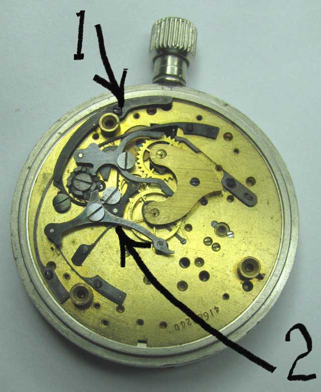

John WoolseyA long overdue update on this timer!
One photo changed (improved), plus a few additons.
Mainly though, a huge mention of thanks to Tom Brown, who sent me a couple of 'bitzers' containing the parts needed to repair it, from which I've managed to get this timer up and running again.
The 'jammed' button turned out to be missing levers, which Tom thankfully bailed me out with.
Also managed to put together a set of hands from my bits boxes plus another that Tom sent.
I've yet to take a shot of the dial with hands in place, which I'll post shortly.
John.
Inner Dome.
June 29, 2009, 10:21
John WoolseyAnother movement shot.
JW.
June 29, 2009, 10:24
John WoolseyUnder dial shot with replacement levers arrowed.
The levers Tom provided were originally a matte grey finish, and which I polished then dunked in Gun Blacking solution.
A quick dip in used watch oil and wiped off preserves the finish nicely.
The screw was also missing, and which I've had to make.
The lever at '2', isn't bringing quite enough pressure to bear on the drive pinion against the centre wheel, so the main hand slips occasionally.
The end of the lever bearing on the cam wheel needs tweaking (AKA shaving off) to allow the lever to move a tad more.
Once that's sorted, pic's will follow with the dial and hands in place.
