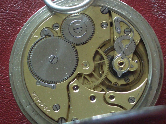

what about this Mark V 30 hours NL ?
I have this Mark V 30 Hours NL, and it seems pretty good, at least to my eyes. But I'm not a specialist in military watches, and I'm rather puzzled by the high serial number, 2270638, see movement below.May I kindly ask for your opinion ?
Thanks & regards to everybody
Mario

and here is the movement

Jim Hester
Ciao, Mario.
The face of your watch is from a British military watch that would have been used in an aircraft during the first world war. These were pocket watches that had a long winding stem with no hoop. They were pressed into a bracket on the instrument panel of the aircraft and then removed after each flight by the pilot for safekeeping.
These watches normally had two serial numbers - one is the serial number on the movement and that was the one given by the maker of the watch. I am not an expert on Zenith company serial numbers, but I understand that they reached 2 million watches made around 1920. If that is true, then the serial number on your movement seems to be too high for it to be original to the dial which is a first world war vintage, but as I pointed out, I am not a Zenith expert and I would defer to anyone who knows Zenith serial numbers. The second serial number is the one given by the British Air Ministry and that is the pair of letters followed by the number on the dial. Many different companies made and sold watches to the Air Ministry during the war and each company was assigned a different pair of letters. The letter pair on your watch face is CB which is the one that Zenith made watches were given. The number following the CB is the sequential serial number for Zenith made Mark V watches so your watch face is serial number 758 of the Mark V watches supplied by Zenith.
These Mark V watches were well made and after the war they were kept and re-used and continuously repaired by the British Air Ministry and Royal Air Force for many years. Because of this one should not always assume that a movement is original to the case and dial and it may be a later replacement. There were still a great many of these Mark V watches being used up into the second world war era. Your dial has a notation on the dial painted by hand in white lettering 'G.S. Type' This would have been added in the late 1930s or early 1940s by the British RAF to show it met the requirements for general service use.

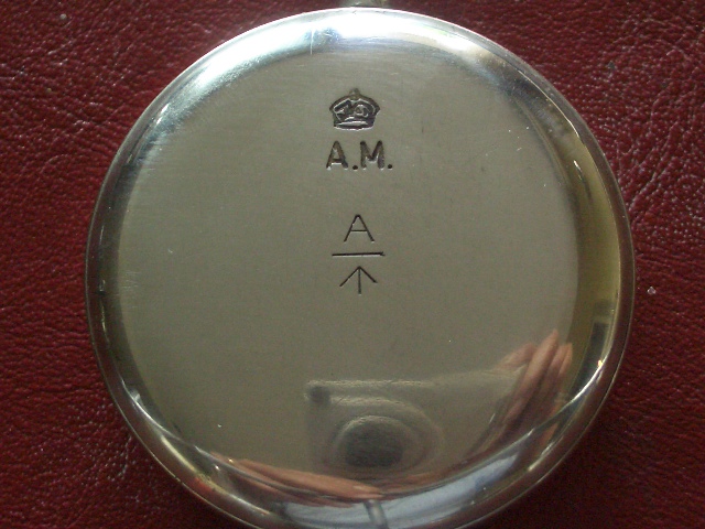

Here follows the back cover, and below the inside of the back cover itself.
Again, have a nice a day and many thanks !
Mario

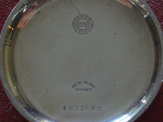

here's the inside

Jim Hester
Very nice, Mario. The "A" "line" "arrow head" marking is the one that would have been applied to the case during the first world war. The Crown and A.M. (for Air Ministry) marking on the back is as you say, a later marking - likely around the second world war.

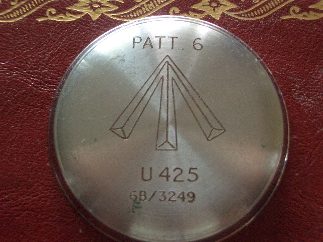

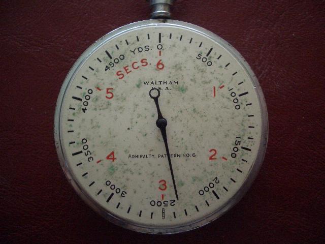

Well, this back markings is quite unusual... I cannot understand why there is the typical wide and big Royal Navy broad arrow AND the 6B marking, used by the AM...
I would like to see the front side, too: maybe this will help.
Do you know and trust the seller who sold it?
September 30, 2009, 07:44
Mario Pagani
Claudio, the PW itself is ok, as you can see

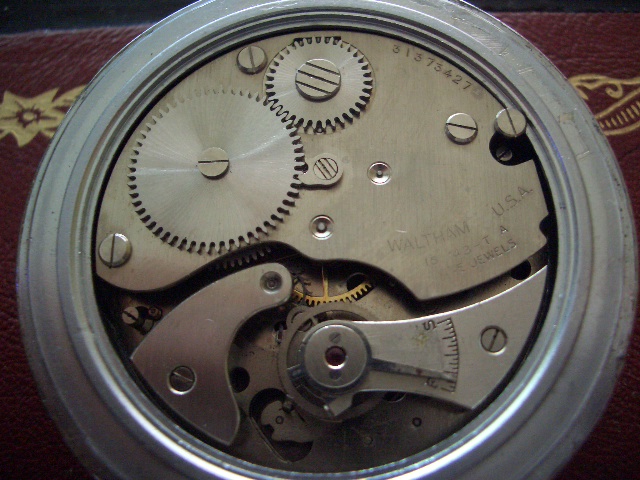

September 30, 2009, 07:47
Mario Pagani
and, more important, movement is right, 1944 vintage from the serial no. Generally, besides my friend Dave here I do not trust much sellers, not because they want to take advantage on you, but because there are so many mistakes & such an ignorance that you have to check three times ... and after don' t buy.
September 30, 2009, 08:05
Claudio Capaldo
Well, I see... I supposed it was a pocketwatch, not a stopwatch... this is the reason I asked for the image of "A side", before to say anything more...
Much better... for me it is ok. The 6B marking seemed quite unusual to me, simply because it is not a 6B marking!
Frankly, a pocketwatch with those markings would have been very odd...
I have always seen those ASDIC timer without that 6B markings, but I must admit that don't know enough this kind of timepieces (never have got UK stopwatches in my hands and never studied...) so I cannot say anything. It seems ok to me.
