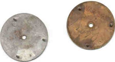

Grant PerryWell, I removed the dial and here is what I found. There is a date stamped Mar 1963 on the dial back. There is also a small notch in the dial at the 3 o'clock position. When I purchased this watch it came with another RFAC dial, which is also pictured below. It has nothing on the back, and does not have the notch at 3 o'clock. Both dials are in decent shape, but my scanner doesn't do them justice. The watch also came with an extra empty case. The back was off both cases and I'm not sure which is the correct back as they are both identical except for the writing on the back. One is inscribed RCAF 6W/12 W6500. The other has a broad arrow and RCAF Ref.No 6B/150 W-366/42. what is the difference between these two case backs? Which would likely be the correct one?

Lau Siew MingI am no expert on this but I have seen both markings before and believe them to be genuine. The dial without the notch at 3 o'clock could be one of the original variant and is less often seen. The notch, I believed, is for alignment when doing re-dialing.

Greg CrockettInteresting find, Grant. Those two dials are extremely useful. It is now more clear that the original WWII dial format did not change as a result of the 1960's repair and refinishing.
The RCAF Waltham I have has the 6B/150 code, which is like the codes used by the British Air Ministry for pilots wristwatches.
I don't know the meaning of the code, "6W/12 W6500". However, the format of the marking is clearly similar to other WWII British and Commonwealth Air Ministry timepiece codes.
