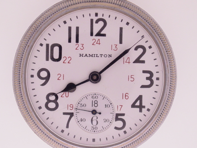

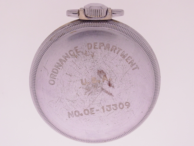

Thanks, Tom. Meanwhile I couldn't resist, and I have bought something that looks like a mythological chimera, a thing with a serial number C98955, that leads to a 992B, with a decent Montgomery dial, a base metal case with an "Ordnance Department" inscription and that OE serial number. Since they say that there's a "US Gov." inscription too on the movement I do think (hope) that I have bought a military 992B with a civilian dial, at least.
What do you think ?

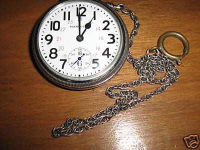

February 18, 2009, 12:25
Mario Pagani
Here the dial

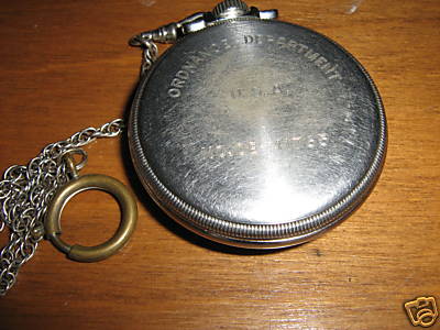

February 18, 2009, 12:26
Mario Pagani
and here the case ...

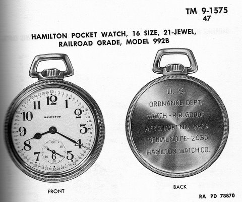

The serial number would put it right for a Hamilton Military 992B, it would be in the 1944-45 range.
The dial might be orginal too, I am sure someone that knows more than me will join in, but Hamilton did make US Govt. models with the whit dial, I just don't know about the Canadian 24 hour numbers.

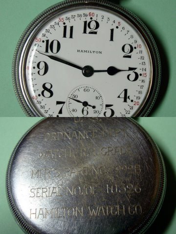

Here is a scan from the US Army training manual of the watch.
book

Here is a photo of mine.
ham

I am not sure but there are some things that make me ask myself whether this watch is exactly as it should be. In looking at the dial on your watch I notice three features that are not the same as the dial shown in the U.S. Army manual on these, nor is it like the other ones of these I have seen including the photos of the one that Tom has kindly shared. Note that on yours the minutes are not marked with individual numbers from 1 to 60. Second, note that yours has red 13 to 24 hour markings where the others do not. And third, note that yours has an 18 at the top of the second hand orbit while the others do not. My first impression is that yours may have a replacement dial that is similar to but not the same as the one originally used on these. Also the markings on the back of the case of your watch raise questions in my mind - they seem to be quite different than the markings shown in the official manual as well as different from actual examples I have seen including Tom's. Again, my first thought is that it is possible that the case on yours may be a replacement case - perhaps from another watch of the era. Finally, I can not see the bow in the photos of your watch - is it the same trapezoid shape as the one in the manual? I may be mistaken, but these differences would make me want to do some more research if I were the owner. Hopefully someone here might be able to add something to this interesting discussion.

Thanks, Jim. To be very frank, I do started thinking that this watch was a chimera, a mytical beast made up of ... components of different species. Be sure I'll check it with a big care when I'll receive it. I had to buy it on shameful pictures, but data pointed to a decently priced 992B, and I personally like Hamiltons, so I couldn't refrain ... Now, I deem that basically I have two chances, either I have got a recased high quality movement with a decent dial, or I have stumbled on a very interesting GI ... in both instances, not a bad buy. I hope

I think I have seen others with a different arragement of the engraving on the case back.

I am not sure what the offcial name is for the type of dial like yours but from reading the posts over the years on this site apparently the Canadian government required their railroad watches to have the inner chapter ring with the 24 hour dial.
I also found another 992B that looks just like yours on the web, it makes me lean more towards yours being complete.
back

The dial
dial

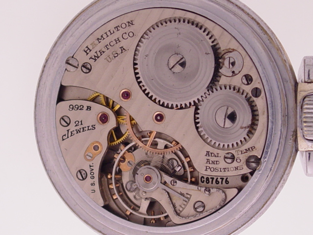

February 18, 2009, 17:30
The movement
movement
February 18, 2009, 17:35
Mario
I found another one on the web that is the same as the ones I just posted, it is serial #C88519, it has the same case markings as yours too, it also has the OE# but it is a differnt number, but I don't think that really means anything now days.
So now that makes 3 total just alike, more & more evidence that it might be orginial, I guess we will have to wait to see your movement.

One more thing Mario, if you read this post Lindell mentions the possibility that the dials like yours with the red numbers was a military dial where if it had black numbers it would be railroad.
https://ihc185.infopop.cc/eve/f...361028871#1361028871

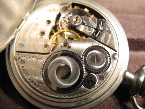

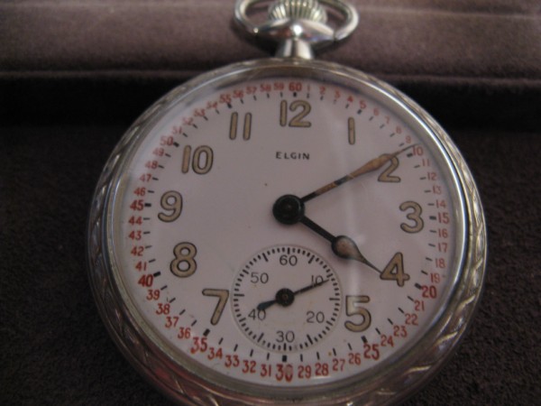

February 18, 2009, 19:22
Bill Manders
Hi all,
I just got this one with a similar dial, but on an Elgin watch. Hopefully this is all original, looks to be with my untrained eye. Any and all comments appreciated.
Bill
February 18, 2009, 19:23
Bill Manders
movement

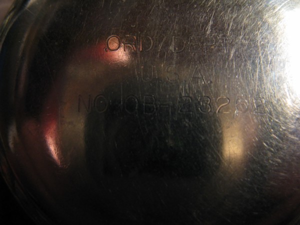

February 18, 2009, 19:24
Bill Manders
case markings
