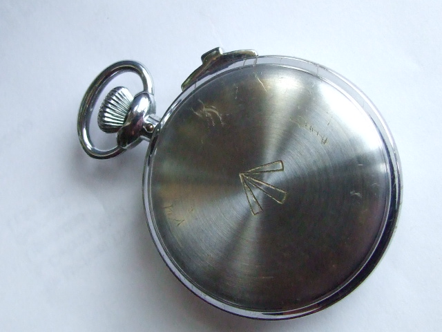

How to spoil a nice stopwatch
May be I'm wrong, but pretending this is a military marking for a stopwatch is a bit too far. I think that they simply damaged an otherwise nice stopwatch. May I have your opinions about ?

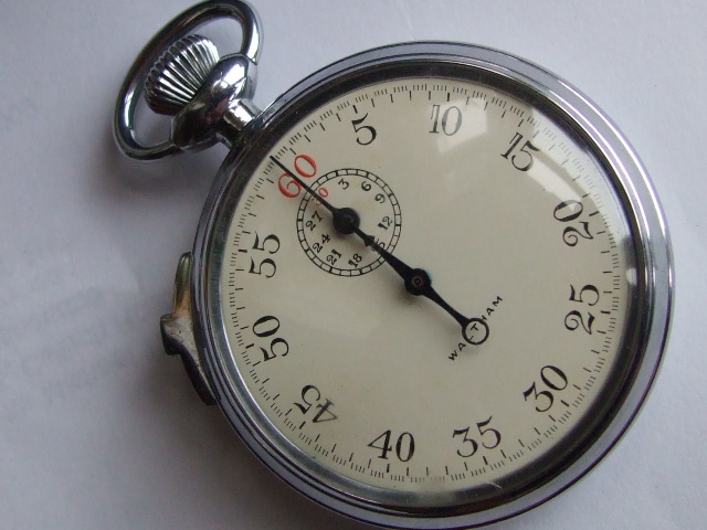

Mario Pagani
and here's the dial side
October 07, 2009, 12:42
Greg Crockett
There is something a'bit off about that broad arrow.
I may be wrong, but the watch looks post-1945, though the arrow looks like a marking from WWII.
October 07, 2009, 12:54
Mario Pagani
Hi Greg.
In any case I think that they tried very rougly to punch the Admiralty way for crowfoot, but the forgot that Admiralty had always straight lines and a rather careful punching: Army and Air Force were quite more relaxed at that, as far as I have seen. May I have your opinion ?

October 07, 2009, 18:15
Jim Hester
My first impression is that this is a fake and that an otherwise nice case has been damaged with it. The carving is unsteady and unlike any other Navy crow's foot I have seen.
October 08, 2009, 09:56
Greg Crockett
Mario, Yes, I think the Admiralty on average had more exacting standards.

October 09, 2009, 11:33
Jim Hester
There seem to be a number of watch sellers in some eastern European countries and southeast Asian countries that are making quite an industry of taking large numbers of old civilian pocket watches and wrist watches and adding fake military markings to them, then selling them on Ebay and in other places as military timepieces to obtain higher prices for them. I do not know if this is one of those, but it reminds me of ones that I see from some of those sellers.
