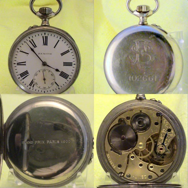

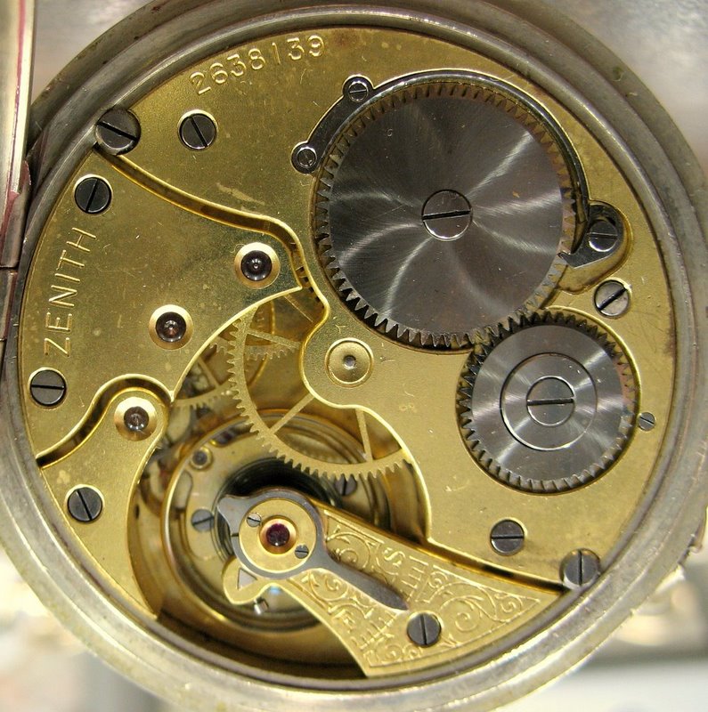

For some time, I have been "shopping" for a Zenith just to "add" to my Swiss watches. I was lucky enough to get s/n 2638139 16s 15 jewel model, which I guess by the s/n is late 30's early 40's. When it arrived, I see that it appears to have some markings on the back cover that could be military, although the dial and hands are not typical military. Any thoughts what "FS 102661" are for?
September 12, 2008, 15:47
Jim HesterI don't know, but a couple of thoughts are:
1: The FS or SF monogram could have been added by some later owner after the watch had gone out of government hands; or,
2: That the FS or SF might be a company or institution of some kind that had a need for pocket watches and this might not be a military watch?
Is the movement inside original to the dial and the rest of the watch? The roman numerals on the dial tended to be more commonly seen on turn of the century military timepieces and not on ones of the 1930s to 1940s vintage the movement serial number suggests, though of course anything is possible. Also, the "Grand Prix Paris 1900" marking on the dust cover suggests to me that the case may be more likely to be a turn of the century age rather than the era of the movement.
It is curious and I look forward to hearing other's thoughts.
September 12, 2008, 18:58
David AbbeThanks for the observations Jim, I was thinking maybe "Securitie Francois" or however the French say that. As for the movement, I have no idea what the real age is. I was estimating from Shugart's note that by 1920 Zenith had made 2,000,000 watches. However that means little as for the actual serial numbers used. It could be early 1900's.
While the watch needs cleaning it does keep good time. I think it's lubricated by nicotine! More thoughts Anybody?
September 13, 2008, 15:20
John WoolseyNice find David, Zenith's in good condition are always very sought after by collectors and make good prices!
I'm not sure the engraved initials would stand for 'Sécurité Française' though. A quick 'Google' throws up too many possibilities really.
The initials appear a bit too 'flowery' for any Governmental office too to be honest.
I think I'd go along with Jim on his suggestion they were added afterwards, the watch being sold out of some service or other.
But, the watch could well have been issued to a serving officer in the armed forces who stuck his initials on it!
The watch itself being pin set, I'd put somehwere between 1900 (the 'Grand Prix Date) and maybe to 1920ish when stem wind/set were more usual.
There are always exceptions with Swiss watches though, but I wouldn't put it a deal later!
Just to add a point about the Roman numerals, if you check my 'H. White' (English Freesprung) military watch topic, that watch is also pin set, hallmarked 1912, and has Roman numerals.
John
October 31, 2008, 10:00
Aldo FeruglioIt is a nice pocket watch but not military.
The meaning of FS engraving is "Ferrovie dello Stato", the Italian railways.
Hope it helps.
Best regards, Aldo.
November 04, 2008, 16:21
Jim HesterThanks Aldo!
That would fit with my second guess that it was bought by some organization or company that needed a number of pocket watches.
While it is not a military watch, it is a railroad watch which I think is just as interesting.

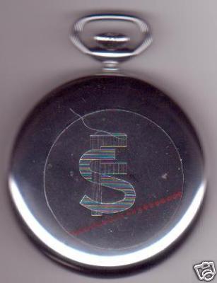

Andrea Schiavihere is a picture from Ebay of 1970's "Perseo' the official watch for the Ferrovie dello Stato (Italian Railway) where you can see a similiar FS mark.
Now,I do not know (even if i am Italian) the railroad requirements during the 1930's.
When the fascism went in to power in Italy many"foreign" English or French words had to disappear to not "mix" the pure Italian language.For example words as "chewing gun or football" were words not to say. Historic watch makers as Patek Philippe or Longines had real troubles to marketing their names in Italy during the Fascism,not having names so called 'Italici' (italians).That is why PERSEO has been chosen as ideal manufacture for the Ferrovie dello Stato,remember the Italian Railways belong to the State and during the 1930's consequently to the Fascist Regime.
Andrea

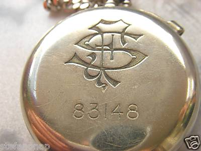

Andrea Schiavi..and here a Longines for Ferrovie dello Stato,Italian Railway.(taken from Ebay)
Andrea
November 14, 2008, 14:19
Aldo FeruglioInteresting this Longines, with the case lugs to be sealed by wire and lead, a stationmaster watch.
Aldo.

Larry BuchanHello Aldo and Andrea:
Interesting watch case, and Italian State Railway History, I would suspect that the pocket watch case was sealed by the watchmaker, or some other official, so the employee required to carry the pocketwatch could not tamper with the regulator. This was an important rule on North American railways, that employees were not allowed to regulate their pocket watches.
